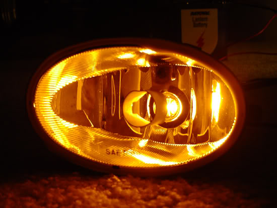

wow you guys wont believe what i finally settled on. i was rethinking the yellow bulb thing, might get too hot, ruin chrome over time, crack lens from heat in winter, look ugly with yellow reflections and stupid yellow tip coating, etc... when i remembered i had a spare set of those led maxxima park light modules i used for my tyc park light. i love these because they only use 50ma and are still super bright and wide angle (uses 3 SMT leds behind a patterned lens). i used a chrome shroud for the ones in my retro, but i also found a set of rubber shrouds they came with. i stuffed it in my fog housing, PERFECT FIT like they were designed for it. the black grommet covers the entire bulb hole from the front, and from the back the grommet securely (tightly!) holds the led in place so no glue is even needed. and can easily be removed. only thing i have to do is put a small bead of 3m windoweld (also removable) around the bulb hole in the back because there are a few open holes. man this worked perfectly! and i can leave them on all the time as running lights. because of the wide angle, they light up so nice at night the whole reflector! pics coming tomorrow. still waiting on lamin-x tho before they go on but wow this is great.
Old Sep 29, 2010
Rep Power: 812
Re: anyone use H8 bulbs in their reflector fogs?

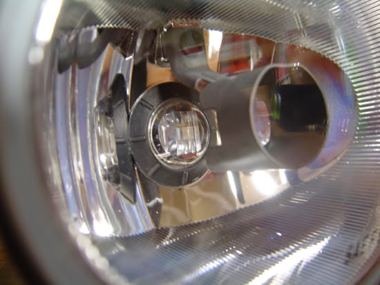

okay my only beef is the chrome in the fogs is already hazy! mustve really been sitting in the box for a while. under the fluorescent lights there is alot of bluish and white haze but its not that noticable during the day at least. the color should be a perfect match with my tyc park lights that use the same module. here are some preliminary pics to enjoy just gotta put the lamin-x on and hardwire these things in place for the last time. finally!
there is a fair amount of light on the ground too, and a nice curved beam pattern. nothing that would be visible with hids on, but still good. depending on the angle of viewing you DO get reflections off the chrome. very clean looking. the metal glare shield is a bit dumb, but it doesnt get in the way much of the light. you can see the bluish messed chrome under the light

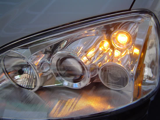

this is what they look like in my headlamp park light

nice. what's the spread look like on the road? are you wanting them to put off any usable light for foggy conditions?
Old Sep 29, 2010
Rep Power: 812
nah no light. even the oems before with 55w bulbs barely put out 1 ft of light past the bumper. the leds put some light right near the bumper that oncoming traffic will prolly see and it will look like fogs, but they are about as bright a a normal park light. having more foreground just wasnt working out and i never used the fogs at all when i actually had good ones. at one point i had projector fogs with halogen H3 and catz zeta, it was much brighter than the oem headlamps lo beam and went further too, but it wasnt really useful at all other than being able to say i can drive better with just my fogs lol.
