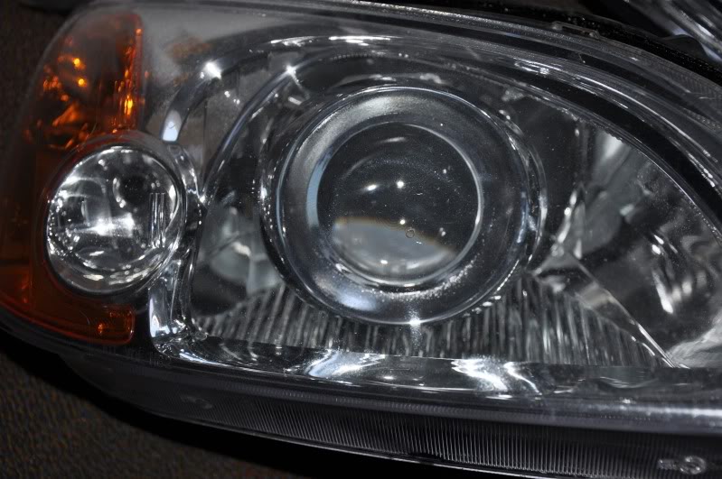

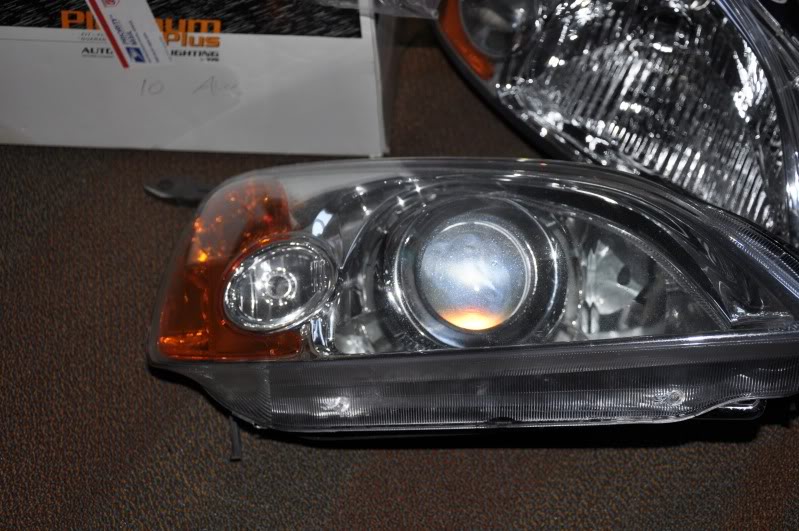

Hmm, 40+ views and no one knows? I think that I discovered HB2/9003 and H4 are all the same. Can anyone confirm that the 02's are negatively switched as it applies to the headlights? Here's a couple teaser pics, E55 bix with E55-R shrouds....

looks great, which projectors did you use?

Thanks man, E55's....
