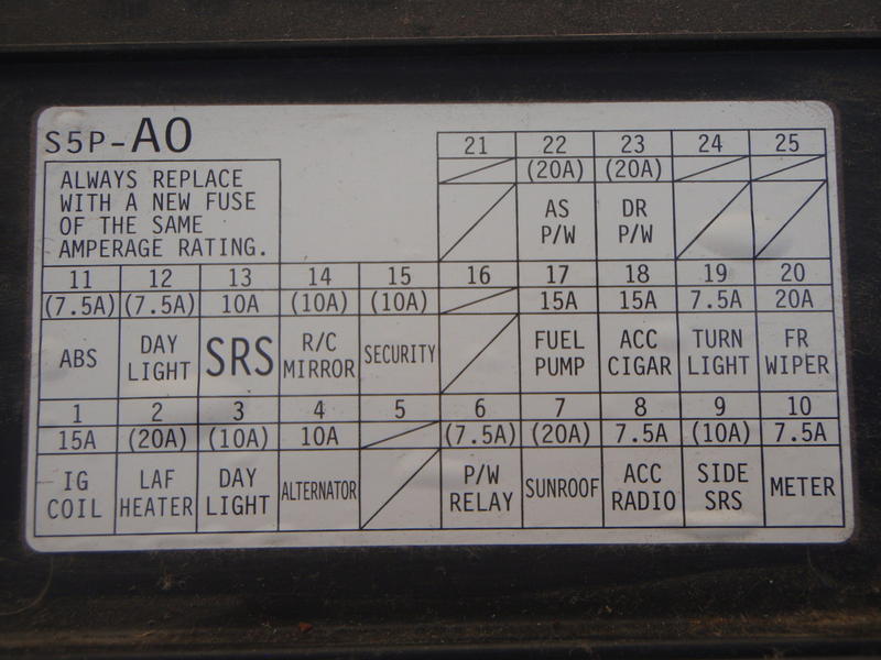

Gearbox, sorry for the newb question but is it a simple fuse pull to disable the drl's in the 02 civic coupe? I'm gonna do a projector retro and I'll need to disable the drl's. Sorry for the threadjack
Old Sep 7, 2009
Re: Hid on drls?
one or two drl fuses to pull out. or you can disable the actual drl module which is next to the hood release lever under the plastic panel.

Any how to's??/ Which number fuses to pull?

Under the steering wheel theres a fuse box, open the panel and theres a diagram, on the diagram it will say daytime i think, theres 2 fuses, pull both them out.

just for reference for any of you guys that dont have the list of what all the fuses are under the steering column fuse box are, here you go. might be a good idea to save this picture.
