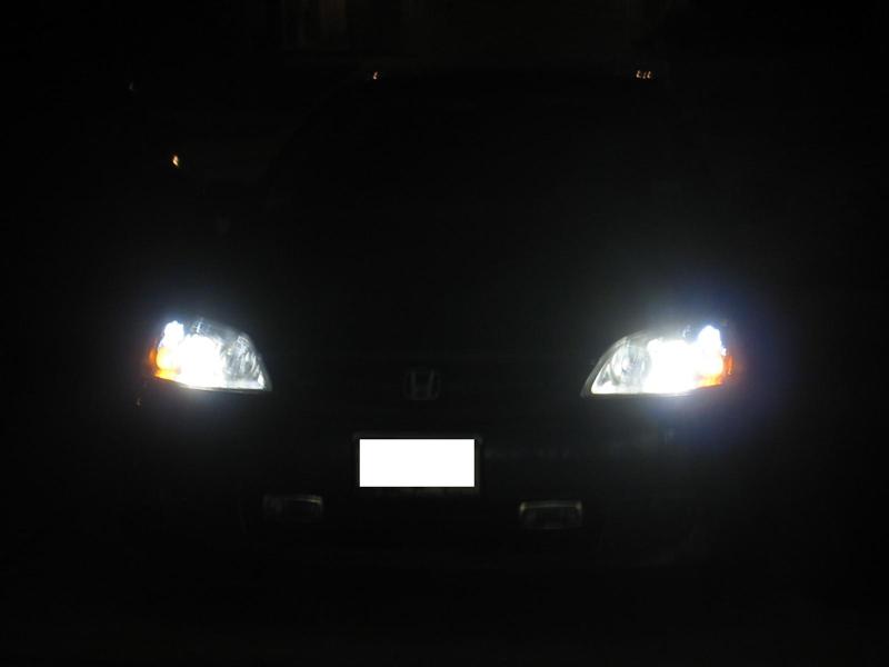

Here's the beam pattern and the looking at the beam......I am thinking it's the chrome reflector at the bottom that casts the glare.....Any idea?

Old Mar 16, 2006
  #34
Rep Power: 812
the wall shot looks good. and yes you are right. that was the same reason the chrome tyc stayed in production longer. they had to solve the glare problem from the chrome housing. they brushed it to fix the halogen problem but yours is making it happen again. you should think or a way to fix it, maybe by painting it chrome (silver) which will be less reflective.

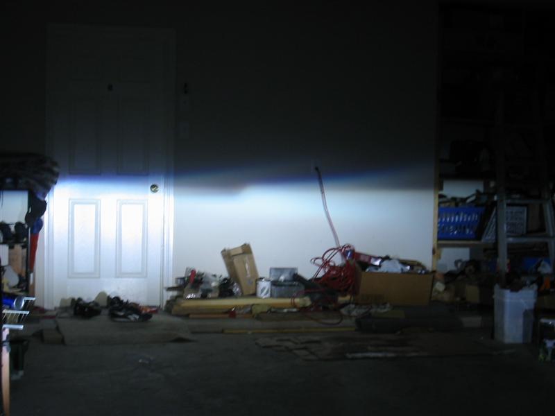

Basically none....Above cutoff there's almost completely dark from side to side.....It's just when I see the road signs it scares me....I don't know if my pic shows anything, but that's the pattern I took at about 30 feet on the driveway from the wall with car front higher at an angle....

Infinite, do you see ANY problem with it? The road is slightly inclined....

wall shot from 20 ft would probably be better.
from what i see, that looks about the same as mine.

Finally......
Old Apr 12, 2006
  #55
dirtySAMURAI's Avatar
I log in from time to time
Posts: 15,682
From: VA
Rep Power: 434
looks good to me
Old Apr 12, 2006
  #56
Rep Power: 812
ya thats great, and as you get closer you should see the cutoffs start to separate. tons of color in there too.
