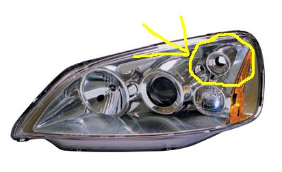

Can anybody tell me what the model number for this bulb is...I need to replace it. Also can anybody tell me how i go about replacing it once i buy the bulb? Thanks.

if you cant reach the bulb you might have to just undo the 8mm bolt and unclip that side of the bumper and pull back the black fender well plastic and stick ur hand up in there to get to it.. if thats too hard or ur hands are too fat.. u might have to take out the headlight.. good luck!

168/194

it should tell you on the back of the headlights...but yes it's 194/168

I have sonar projectors, which contains 4 bulbs in all. I want to replace the bulb in the black ring (as circled in the thumbnail) as well as the green ring (also circled). From what i have been told, one of these is a 168/194 bulb, but i dont know which one, and i have no idea what the other bulb size is. Can anyone help?

ok i figured it out. The bulb in the green circle is the 194 bulb which is the actual turn signal, however, the parking light bulb still remains a mystery...

the turn signal is the one that blinks. dual filament 7443 is what comes oem/tyc. i dont know about sonar.
single filament 164/198 doesn't blink but just stays on.
