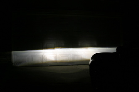

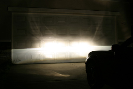

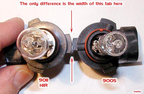

FYI guys who wants to know alil bit more about lightning and who are tryin to decide between HID and some SuperduperXenon bulbs. I would recommend is to look for HIR bulbs.they are much better than HID for halogen lamps.
The d2s is original HID bulb for HID projectors, d2r is original HID bulb for halogen lamps.All aftermarket HID kits use rebased d2s bulbs made for specific lamps:h1, h11, h3, h4, 9006 etc.Sometimes the quality of those rebased bulbs is questionable.
On the other hand the HIR bulb produces 2300 lum on low and 2700 on hi beams; the d2s is 3200 lum., the halogen bulb is 1800 lum.
The HIR bulbs are available only 9005/6 and h3 application.
pic 2 - with lo beam
pic 3 - with hi beam

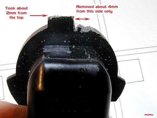

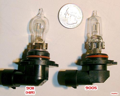

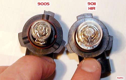

he was referring the Toshiba bulbs.They are the newest bulbs right now, cuz GE sold a patent in 199...to japanese companies, especially IPF and Nissie making those bulbs.They are a real brightes bulbs out there.They will last for years.They do only 9006, 9006 and h3 types.All of those bulbs are real from Japan.Average price is 150-250/pair.
By the way you aint right about HID.They are the best right now for halogen housing, cuz you`ll have the same output I guarantee.
and for ebay bulbs I can give you some interesting info:Check it before you buy them:
