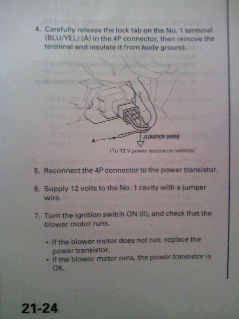

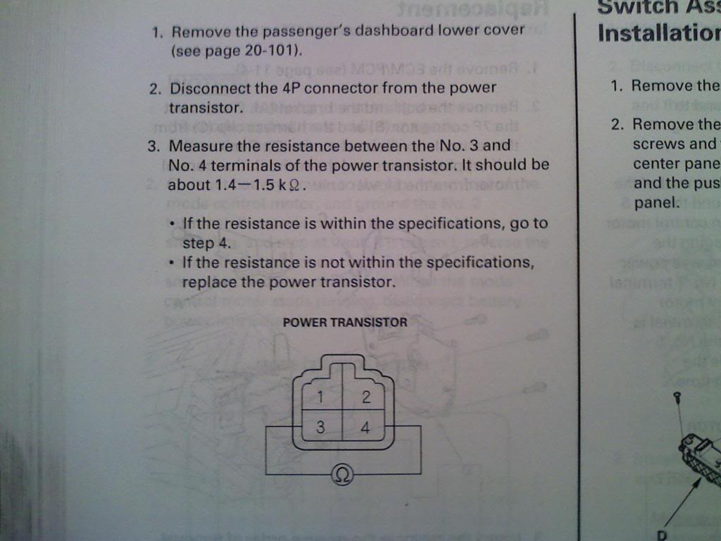

Transistor test (lower left side of the blower motor assembly under the passenger dash):
Could it be the evaporator sensor? or the control switch?
To the OP: does the A/C work ok?

Problem 1 Blower fan/ No A/C: Mentioned "Transistor" did you test it ?? Replace it ?? $25 (the A/C system will not engage without an operating blower fan)
