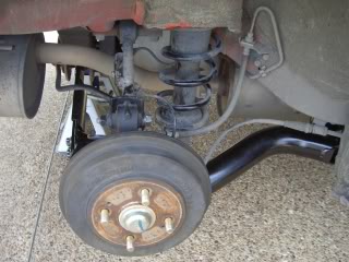

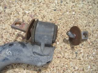

Well, after a day of searching online I couldn't find just the little pieces. Here is the ONLY thing(other than rims+tires) damaged in a 40+ mph drive up a curb:

Unfortunately, you can only buy a complete control arm which sucks since its obviously designed to break away at the two little connection bolts. I even asked if we were to pay the dealership the labor to fix it, if they would be able to just get the little parts and they said they would still have to charge for the entire control arm.
So here is what I ended up with. On a scale of 1 to 10 (10 being hardest) I say this fix is a 3. Not really any harder than replacing struts or brakes. It took me exactly 1 hour 45 minutes from jacking it up to letting it back down.

If anyone out there wrecks their car like this, I definitely recommend you try this fix yourself if you have done a brake job or a strut replacement. Save yourself a few hundred bucks
