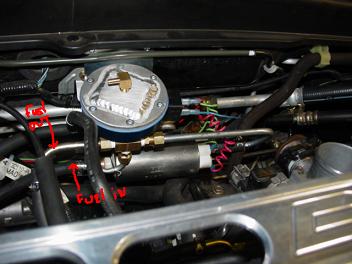

Our fuel kit does the same thing to the stock injectors as the FMU on the older style civics. It does not put any more stress on them than the FMU systems that almost every other turbo kit for the older style civics used.
I do have some close ups of the fuel system, so i will show them to you. This is the one installed on yourinmyw0rld's car.

i also have over 4500 miles on my car with this turbo kit, and it is showing no signs of anything going wrong. Most of the miles have been with the boost set in between 6 and 8 psi.

Forgive me if I don't understand, as I don't have past experience with turbo kits. However, I'm still trying to figure some things out. If the fuel device essentially regulates the amount of fuel that the injectors get, how do the cylinders get enough fuel? I'm assuming that they will run at a higher duty cycle than stock to compensate for lack of fuel at higher boost? This is where the "extra injector " syndrome comes from in the other kits out there.....

The fuel kit on my car, increases the fuel pressure. It doesnt touch the duty cycle. The car runs completely stock until you hit boost. Then it increases the fuel pressure as the boost rises. By raising the fuel pressure, you are giving the cylinders more fuel with the stock duty cycles.

What sort of feedback is used to the device to tell it to increase the fuel system PSI? Is it a sensor (TPS sensor?).....

a vaccume line that pnumatically increases the fuel pressure by putting pressure on an internal boost reference diaphragm.
This is not an electronic device, it is completely pnumatic.
