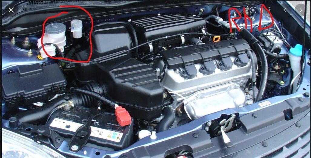

hi there, so I want to k24 swap my civic at some point, and I know that it is going to take a lot of effort and a fair amount of cash. That being said k24s over here in Aus are quite expensive ~$3000 USD and that seems quite expensive compared to the around $1000 USD prices in the US, HONDA ACURA TSX K24A RBB 3 LOBE VTEC ENGINE MOTOR 2003 2004 2005 2006 2007 2008 | eBay I found this place selling for around 1k USD and stating it has around 31k miles, which I would guess is quite low for a Honda motor, I was wondering about if it would be a bad idea to ship from the US to Australia and if I should jump on this deal or wait until I'm more prepared to perform the swap? (if I bought it now it would definitely sit around for a few months before being swapped into my car) also would it be any more or less difficult to swap a RHD civic compared to a LHD model?

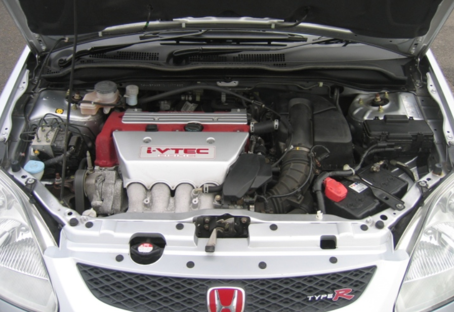

From an EP3 Type R.

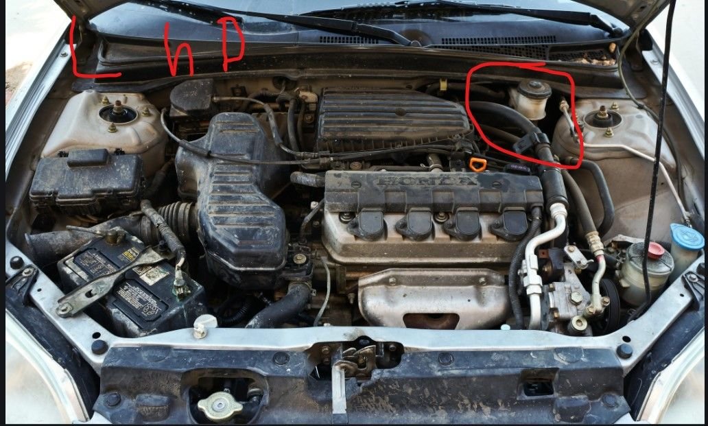

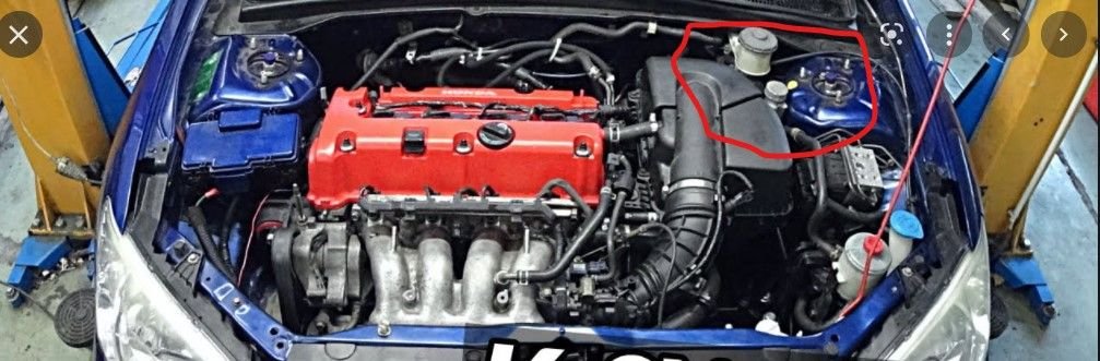

that fits well hahah, so the battery need to be relocated to the trunk or could i re locate to the other side of the bay like on the EP3? and the fuse box and abs are on the opposite sides to my car but that should be fine, how similar are the mounts in the EP3 to the es1 k24 adapter mount things? as in would the engine end up in the same location in the bay? ive also heard that i might need to make a cutout in the hood if i want to keep the power steering?
I never tried swapping to the other side, just put mine in the truck. It's now actually mounted to the back of the rear seats.
No issues.
They make K swap mounts for a reason. It would be in the same place.
If you want to keep hydraulic power steering, yes. You can use an EP3 idler pulley to avoid cutting the hood. Either have to go without power steering or EPS swap.

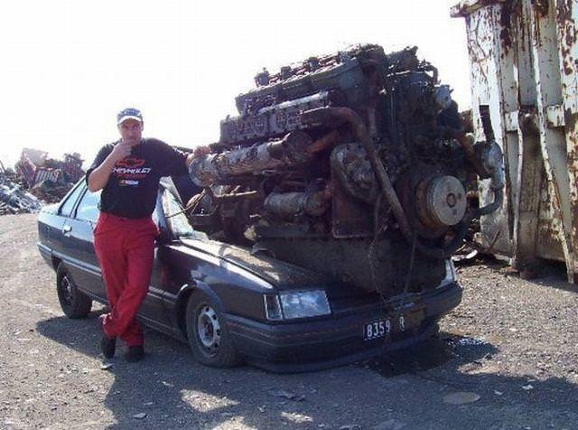

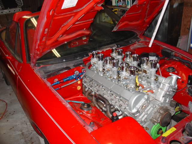

Old Dec 16, 2021
Posts: 15,190
Likes: 1,609
Re: k24a swap rhd civic
fair enough, so basically only the k24As are swappable then?

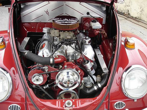

with enough money, time and ability (meaning wants to do and will do instead of asking) time, anything is swappable
hahahah that's very true! i am going for something that has a decent value for money though
