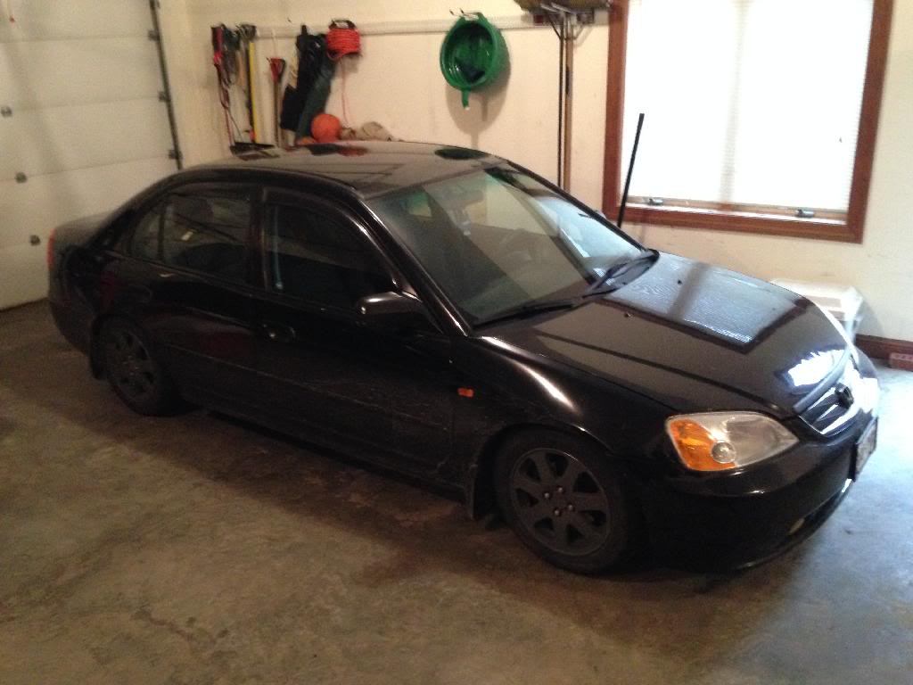

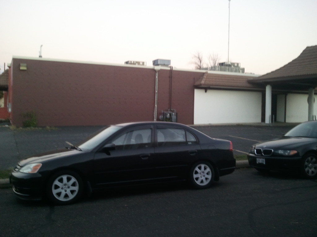

So amongst building the other car I have decided to do a mild turbo setup on the daily (shooting for roughly 180-200whp & relative torque), just to make things a little more interesting. That and I have most of everything to complete it just lying around as extra anyway.
ep3 seats, and you can see the em1 creeping in the background

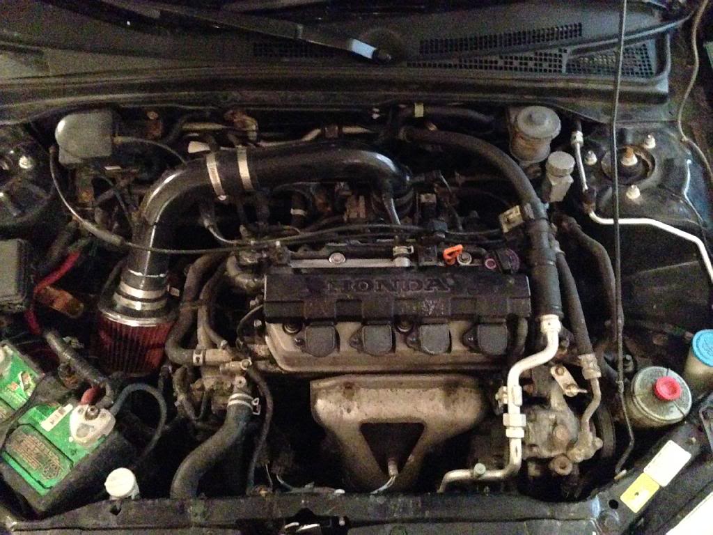

And at last, the ugly, stock bay lol

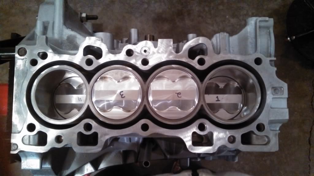

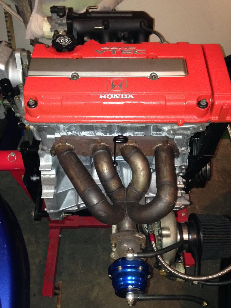

Some other fun pics of the 2nd project:
Semi-built turbo b16 (aiming for around 400-450whp)
