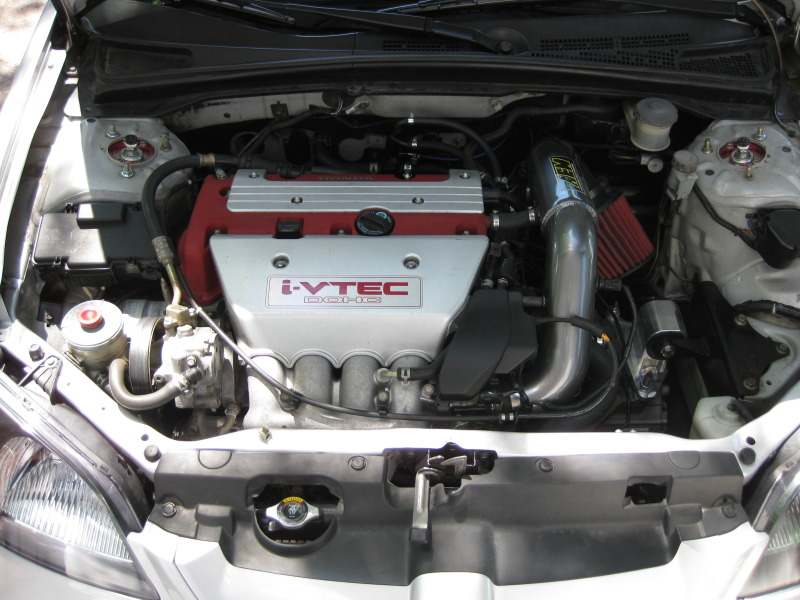

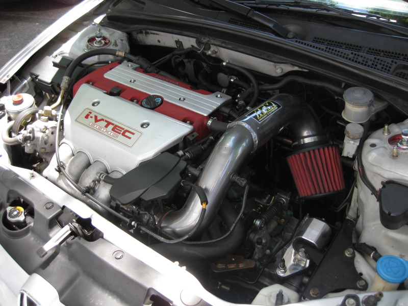

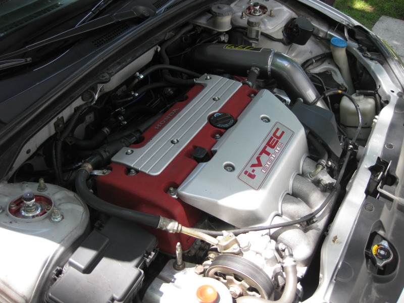

All CEL codes are gone!
IT'S DONE!!!!!
It was A LOT of blood, sweat, tears and burns but she's done. And holy hell, she pulls hard. We had fun trying to chase two CEL codes. Turned out being two shitty O2 sensors. She's fixed. She passed emissions testing and she street bound now.
