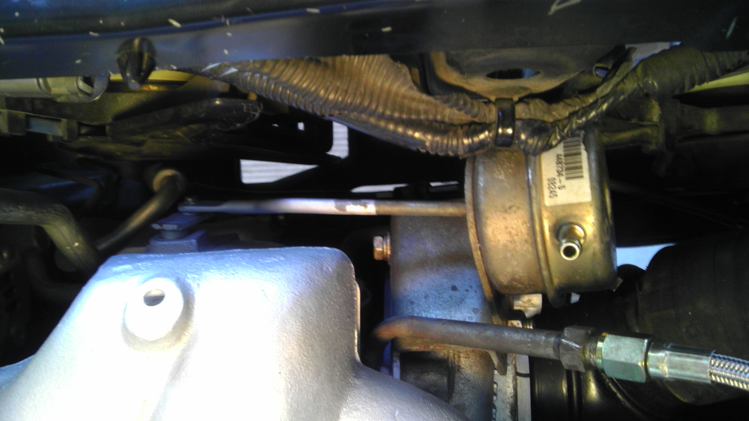

Can someone please identify this piece of my turbo
Im not sure what its called, and where the vacuum fitting and line is suppose to go .. its a garett t25 dual bb turbo.. also, where does the vacuum hose on the compressor go?
im talking about that gold round thing with the little nipple on it and the rod on the side

It's the wategate actuator. It opens up the internal wastegate to control the boost level. You need to run a vacuum line from the nipple in the picture to the one on the compressor.

Thanks, one more question, the actuator rod is kinda stiff is it suppose to easily move?

As long as it isn't stuck, you're okay. It will take quite a bit of force to move it by hand, even with a 9psi spring.
