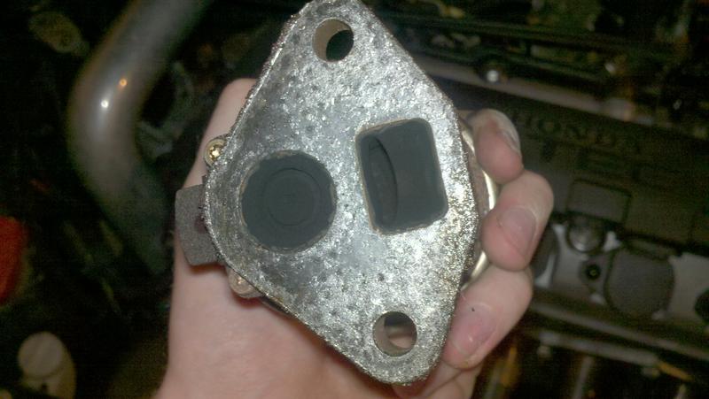

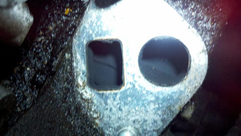

Rough idle and stalling has returned, maybe found the issue... I'm gonna spray some carb cleaner in the egr valve, but wtf do I do about the holes it attaches too.

yeah thats a problem. a member here cleaned the ports in the engine, but it was a big pain. there is a diy thread around here from a month or two ago. i couldnt really clean much carbon out with the spray cleaner since it was the hard kind that didnt dissolve. usually unless the egr code comes up, it should be fine.those passages do get fairly clogged over time tho. do you have any engine codes now?

Fill them up with cleaner, throw a rag over 'em and let it sit overnight before you try to clean 'em out.
