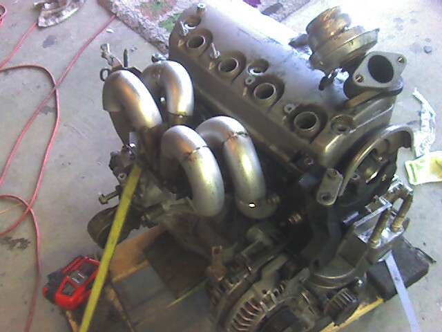

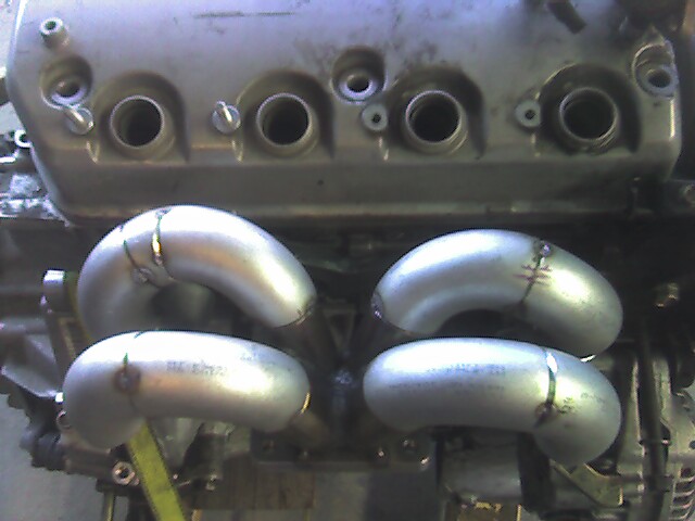

I have had a lot going on. I just finished taking 32 units at Cal State Bakersfield over the spring quarter in order to finish my Bachelors. I am now moving on to attempt to attain my PhD in Economics from Berkeley.
Ive been simply working on my car over the weekends and doing schoolwork on the week days. Only god knows how many different intake manifolds ive made. Suprisingly, I am using the stock one at the moment and the car is naturally aspirated due to a disagreement between me and my 60-1. I told it cigarettes were bad, but (like all children) it defied me and started smoking anyway.
So i am taking this opportunity to build yet another new setup. It took too much to make power with the remote mounted setup. And there was also the constant fear that my passengers side headlight would melt from the placement of the turbo. So i am in the process of building a new manifold. I have assembled my second motor and trans and put all the accessories on it, just so i had an accurate representation of my engine bay in order to build the new manifold.
These are the only recent pictures i have. The manifold would have been completed already, but i ran out of stainless weld-L's
Has a 37* merge collector, seam welded and ported inside. Fully made from 316 stainless, and 100% TIG welded. That damn POS MIG will never touch this manifold. I made the header flange by hand on my band saw and drill press, and ordered the T3 flange, wastegate flange, and downpipe flage from ATPturbo.com.
Like i said before, i am really really busy at this point. So i will not be responding much. Im simply updating because someone whom i added to my MSN a long while back has been bugging me constantly about posting. And no andy, im not talking about you
