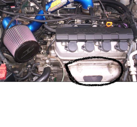

The thing that heat up is the thing i cirlced in
As i let it cool off, my car started fine again. Should I check my spark plugs to make sure that it wont detonatE?

yeah, manicat. Nitrous raises EGTs, you're not moving (no airflow) you nuke it. If you're running real hot and real rich, you fuse the cat shut, then no air moves cuz its clogged and you have a bigger problem.
So look at your A/Fs with a wideband, and have the damn thing tuned before you blow it up.

that's your header, properly known as your exhaust manifold. you shouldn't use n20 any time accept while moving, and even then I wouldn't use it in first gear. The auto tranny is weak as ****.
