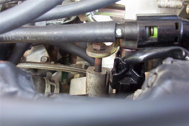

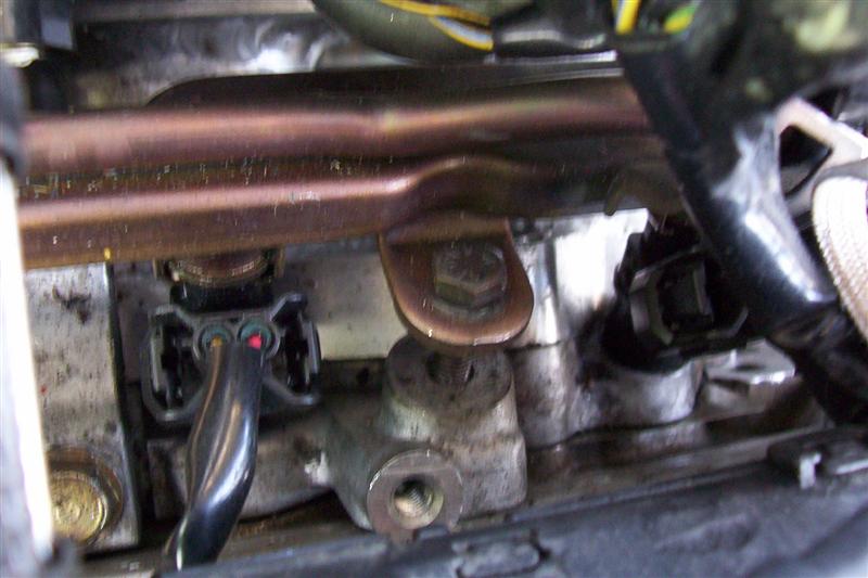

I didnt realize the rust a had on there.. uhm yeah don't overtighten them if you aren't using spacers/washers. Just tighten em up snug so you dont crack the injectors.

Anybody try to put a rubber or metal bushing in the empty space on the new bolt? Probably would not accomplish anything but aesthetics. Just an idea. Do not have them so really cannot play with the idea.
I had one in my 7thgen.

a stack of washers is a tuners best friend. instant spacer.

^^ agreed.. laziness is the tuners worse enemy (my enemy shown above)
