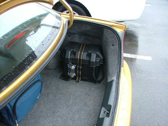

Here's my simple relocation (and a pic of my new horn). Used welding cable that was a given to me (00). Be sure to route the wire carefully to prevent chaffing, and definately put a fuse on it. I used a 100A fuse.
