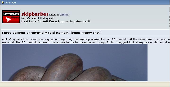

i need opinions on external w/g placement *bonus money shot*
edit: Originally this thread was a question regarding wastegate placement on an SF manifold. At the same time I came across a sweet *** deal on an SFP manifold. The SF manifold is now for sale. Link to the f/s thread is in my sig. So for now, just look at my pile of **** and drool.

ide say place it someone on cylinder 3

it's a pretty cruddy used SF manifold, got it from another member on the board.
where on cylinder 3 would it go? the wastegate is pretty tall..

i would bag the externanl and go internal it will never regualte it properly unless you can tap in right at the collector

yeah, there is no way that wastegate is going to work properly on there. the collector on that manifold looks really shitty too..... doesnt come together very well, more like all the pipes were just welded together without the concern of a good flowing collector which could cause flow problems with the turbo. i would highly recommend a different manifold if you have the funds. i sent you a PM on what i would do if i was you...

Yeah I would def recommend getting a new manifold. Those SF manifolds were far from good.

it will work fine on one cylinder. Look at the most mass produced manifolds with external wastegates. They work fine. Like the ATP cast manifold for the SRT4. It is on cylinder #1. I have personally worked on a car that made 550 whp on that manifold with a tial 38mm wastegate.
I agree that it is not as efficient as tapping into the collector, but it shoulds work just fine for what you are doing. That is, if you are staying with that manifold.

i would just run it internal

His pic shiws he has ext wastegate. Turbo not seen, but it might be non-gated one.

Exactly. Look at the drag manifolds. Alot of people use those and they have it mounted on a single runner. They work just fine. I mean, if you plan on replacing it anyways, you may as well use it in the meantime.
