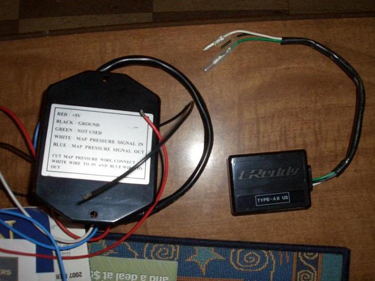

these two parts where not installed on my turbo kit and i am wondering what they are and if there is a need for them. i have the tsi kit with GReddy e-manage.

im not sure what the small box is but the big one on the left is some sort of external type of map sensor voltage clamp. You don't need it because it is built into the emanage and you can set the clamp through the support tool.
whatever the greddy thing is looks like it has an input, an output and a ground. I just dont recognize it.

Big box is a "missing link" type of thing. I dont know what the small box is.

I have the same small box with my emenage. It came from a emanage from an RSX turbo kit. It's a knock box. It helps the emenage detect knock from the stock knock sensor better. Yet I have not wired mine up yet cause im not too sure how it interacts. Im gonna check in on CRSX and see if the members there that have their greddy kits wired theirs up.

I had the TSI kit the big black box is for the MAP sensor to fool the ECU the little one i'm not sure of.
