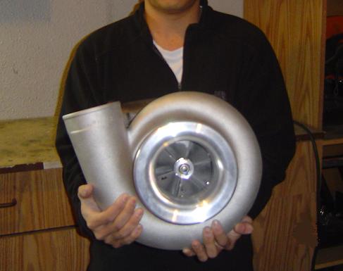

cool tittle huh ...i like it well i just wnated to vent my depression today being as how its xmas families gather and i was talkign to my brotherin-law(hes a mechanic) and telling him how i wanted to buy a turbo kit for my car and he said he had an extra one he didnt want and would give to me for only 600 and help me put it on YES!!!! but then just to bust my ***** he discovered my engine wouldnt be able to handle it because it was meant for 4.0l engine and well he said mine couldnt handle it dam!!! now my question is why is it that my engine couldnt handle it what would happen??? to my engine???

The turbo it's self is designed for a certain amount of displacement. In other words, your engine will not push enough exhuast through it to spool it up. Think of putting a fire house nozzle or your garden hose. You would not be able to build boost and your car would lag and probably bog out and stall the car every time you try to start moving. BTW, $600 is not a good deal on a turbo unless it is brand new. You can pick up used turbos for around $200-$300, and those are good ones.

ummmm turbo......yeah man, when turbo shopping, there are a lot of things to consider such as mods, displacement, the power output you are looking for, etc....its a little more difficult than just slappin one on under the hood...there are a ton of awesome turbo gurus on here that will be more than happy to help you....hit one of us up for some help....

that looks like a turbo off a desial truck or something. I love seeing thjose giant things slapped onto the race cars in NDRA and NHRA sport compact series. but anyways it is about displacement to spool the trubo. A few years ago you couldn't really run anything bigger than a T28 on a small displacement basically stock civic. But modern turbos you can run bigger like a T3/T4 and not get the lag becasue it is ball bearng and they spool up faster and easier. But if you want a turbo for cheap go find a wrecked eclipse they run T25 non-BB, or maybe an old daytona or somehtiung that runs a T3.

holly hell thats like a turbo for a diesel..

i was a diesel mechanic until i was injured in early july. I worked on nothing but large Detroits, large cummins, cat, etc. And i havent seen any *rig* that uses a turbo that large.
plus the velocity stack on the compressor housing is a dead give away that is it meant for a race only application. Unless that is a v-band clamp flange. In which case it is probably meant for some sort of heavy machinery

Mmmmm bulldozer turbo (I really don't know)
Anyways.... the other issue besides it not spooling is what happens when it does spool.
It wants so shove air in massive quantities down that bottle neck that is the intake manifold. It can only absorb so much and you'll be causing back up like crazy (or engine goes boom). The flow rate of a large turbo would cause you to run a pound or 2, which would cause a huge amount of air mass without a lot or pressure. You wouldn't really have the turbo running in its effeciency range doing that.

I don't think it would be able to spool up, but yeah if it did, you would have serious problems handling that much air flow.

I agree.... it wouldn't spool for the same flow rate issue that would prevent it from being incapable of handling the inlet volume, but it could blow up if it did spool. You may see one of those nitrous style intake manifold explosions.
