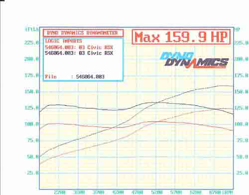

A K20A3 swap can run low 14's with a DC race header, Hondata and a Fidanza flywheel, ITR LSD. I know because I have one. I dyno'ed at 160 whp and 133 wtq (ON STOCK INTAKE, EXHAUST) also don't get a k20a I had so many wiring problems with mine I returned it and got a k20a3. My k20a3 had only 7k miles on it and it was only $1900 (for engine, Tranny, ecu, axles, sub frame, wiring harness, everything) my engine dyno'ed the same numbers as a type-s (he had I/E) and smoked a GSR that had (I/H/E) also I dyno'ed 19 whp more then my d17 t25 turbo!
- A N/A K20 is a 1000000x more reliable then a Turbo d17
time slips?
I have trouble believing this.
drivetofast with a 5psi s/c k20a3 ran a 15.3 with a 2.4 60' time.
there's no way you can run low 14's with lsd, flywheel, dcrh and hondata with a k20a3. 160whp is not nearly enough for a low 14 second run ... you have to be trapping about 98 mph with a perfect launch to run a low 14.
