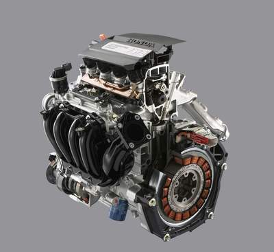

I found a picture of the new r18 if anyone hasnt seen it. I guess its a 1.8 liter sohc I-vtec. Someone tell me if those are individual throttle bodies on top. I wasnt able to read the HP rating because 95% of the article was in chinese. I dunno the engine looks weird. Maybe it will be a future swap.

Is that the hybrid?

the r18 is the new ex motor. It has 140 hp. Why would u swap that into your car when u could swap a k motor in. I don't even think itll fit the 7thgen body anyway.

This is the quote about it in the latest edition of honda tuning.
ALSO your pic IS of the hybrid engine NOT the R18
"When the new Civic coupe and sedan hits showrooms this fall, it will pack a 1.8-liter SOHC iVTEC underhood. With 140hp at 6300rpm and 128 lb-ft at 4300, Honda's lastest econo-powerplant might just make us forget about the tired 1.7-liter in the current Civic and bring performance up to sililar competitors like the Mazda 3'(150hp), Chevy Cobalt (145hp), and Ford Focus (136hp).
The new engine is shorter, lighter and quieter than the current 1.7 due to aluminum rocker arms, silent cam chain, and high-strength cracked connecting rods. A 81.0 x 87.3 bore and stroke, 10.5 compression ratio, variable-length intake manifold for higher torque, and pistion oil jets add up to a serious evolution of the single-cam package many of us have come to love.
The close-coupled cat positioned right after the header complicates things a bit, but not beyond some ingenuity. In stock form, the car and high-precision air/fuel ration control puts the engine below ULEV-2/Tier 2 Bin five emission levels in all 50 states."

that motor does not have ITB's. Just look at it, you can see the intake manifold.
I looked at one of these motors up close the other day. It looks like Honda integrated a MAF into the system along with the ever-present MAP sensor, probably to get it even more hippie friendly.
Also, they did the same thing with the cylinder head as they did with the accord V6 motor. There arent individual exhaust ports anymore. They share one common port into the catalytic converter.
The bolt pattern is almost close enough to bolt a T3 directly to the head. Now wouldnt that be nice of honda?

that has to be a hybrid motor.

Read what i said, that is the hybrid motor. The dude got it wrong, theres a pic in honda tuning with the label HONDA'S HYBRID beside it, he took the wrong picture .

hey..oil filter on bottom!! =D
