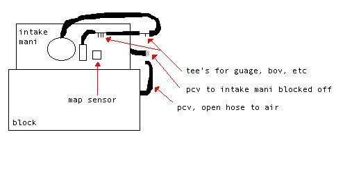

So more problems today. I went and started to diconnect things to figure out why it is running badly. I pulled the fuse for my MF2, disconnected my wastegate, removed missing link, pulled the intake piping so its n/a, and put my stock plugs back in.
Car should be running like stock right now. Started up fine, but as soon as it warmed up it started to idle poorly again, stumbling and almost dying. It also wont rev up at all, if I give it gas it just sort of bogs down. Seeing white smoke out the exhaust as well. Did a compression test and all is good. Pulled my dipstick while the car was running to check my oil for coolant, and the pressure sprayed oil out the dipstick tube onto my hood??
I am thinking I am going to return all my vaccum/pcv hoses to stock tomorrow. This picture is my current setup. Any thoughts??

Instead of using the vacum like you have it, I used the golden eagle vacum manifold and taped off of the brake booster line.

So when you disconnected the mf2 the car still bogged down right? Make sure you unplug the mf2 totaly.
