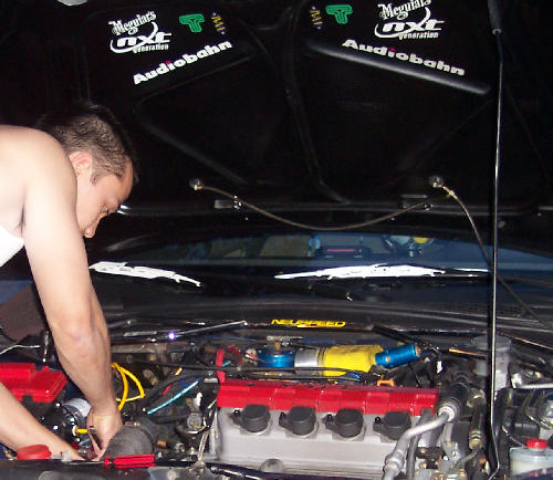

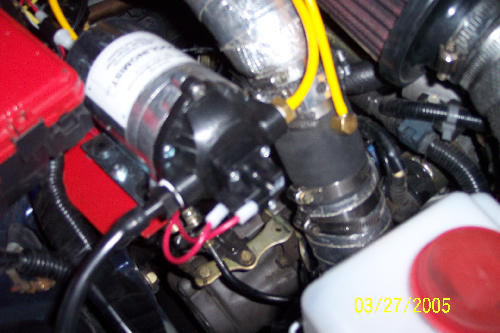

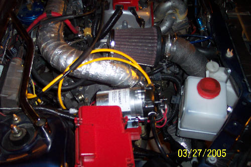

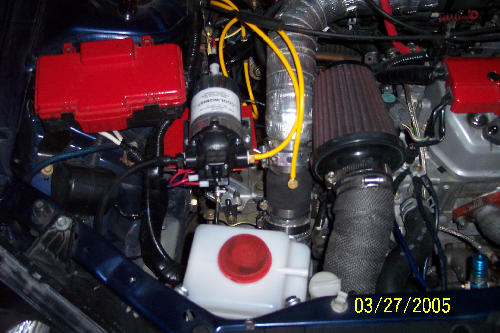

I just finished installing the kit... and damn! @13PSI I spun my tires on 3rd gear like i was on 1st and 2nd alcohol injection is awesome...
don't mind the roots under my arm
www.coolingmist.com single stage kit
1/3 ethanol 2/3 purified water
100PSI H2O Pump...
...i'm still waiting to get it tuned... anybody know a good dyno shop in cali? fuvk it... i'm driving to cali to get my car tuned...
