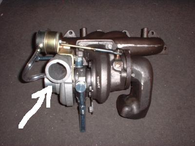

another thing that has me stumbling is the inductor side of most of these T28 and GT28's i'm finding. They look different! Here's a pic of the inductor side of a Garrett T25 that comes with the TSI kit:
Then here's a Garret GT28 inductor side:
It's different!

Here's a nice GT28R for $900 but the entrance to the charge pipe is different from the T25

Any garrett with a T25 flange will bolt onto the manifold.
The GT28RS is available with different compressor housings, for instance:
This is one from the cheapturbo.com store.
I would recommend this one, with a bit smaller turbine A/R.
You can buy adapters that bolt to the turbo to convert it to the normal pipe and silicone hose.
