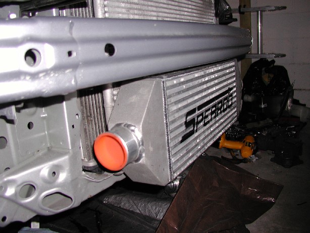

Pics from the "bomb shelter," (ala the Crystal Method)
Patiently awaiting her transplant:
Yum

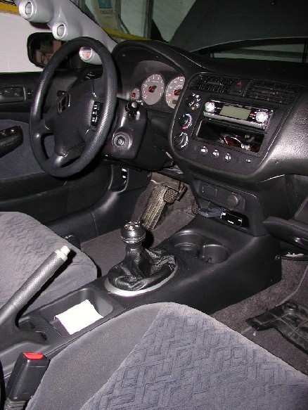

Two more to keep you salivating:
Money shot
Cabin - See anything right in front of the shifter? Could that be a PLX devices wideband display??

is that a SX 1:1 and a return, if so damn good choice, as far as loudness on the open dump tube, the higher the PSI the louder it gets, i like the sound, personally, plus connecting it back to the exhaust, takes more time, more welding, and loss of HP, the tube kinda makes a sputter noise from the wastegate open/closing. sounds mean as hell, when i get the car back i might go down and get PROD AND JODSTER, to make a video so u people can finally see and here my ****.

Nice OPTO. You gonna loose P/S & A/C? Looks like your routing the C/P on both sides.
Edit: Nice Spearco FMIC.

If he routes his piping like ImportRacer2123 did, he will only lose his A/C

Are j00 sure? In the pic the condensor is still behind the FMIC.

Neither - I am losing my windshield washer bottle!
Just have to find a place to put a smaller replacement one.....
I have an LX, so I can route my piping up the drivers side (no ABS modulator).

dam you, I wish i could run it that way but i have an ex so i have my piping routed over the top of the core.

Hey Opto what are the dimensions of your intercooler?
