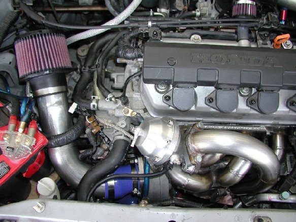

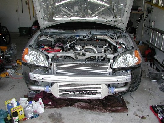

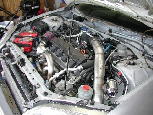

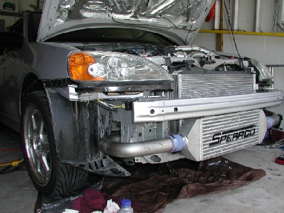

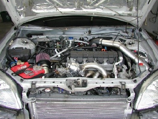

Good news! After performing some inital checks, and testing my gauges - it starts!!
I do have a few minor problems (such as SF's damn downpipe design - I have an exhaust leak!! I need to find a donut gasket that will fit). I can tell the emanage injector correction feature is active, the car idles a little rough - needs tuning. The A/F is almost dead on tho - right around 14.7-15 at idle, so I'mn not worried about it being lean at all.
Still need a boost gauge before going for a ride - last thing I need is to blow the engine after all of this work!
I let the car idle (up on jackstands) until it reached operating temperature. So far there are no oil leaks, or smoke. I'm crossing my fingers that this won't change!
Here are some pictures of everything:
