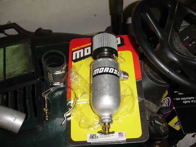

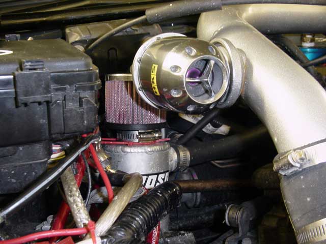

Either run a hose from the valve cover to a breather system like the moroso, or if routing back to the turbo, run a line from the valve cover to a breather tank, then the top port of the tank to the intake pipe before the turbo. Those are the best 2 ways to do it.

Here's what I bought and here's the only pic I could find of it installed...

The idea of a breather is for the valve cover to be able to BREATHE. It's not supposed to be pressurized. If you rout it into your charge pipe, you are compressiong the valve cover and could ad unneccessary heat.
