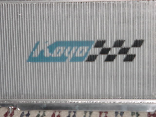

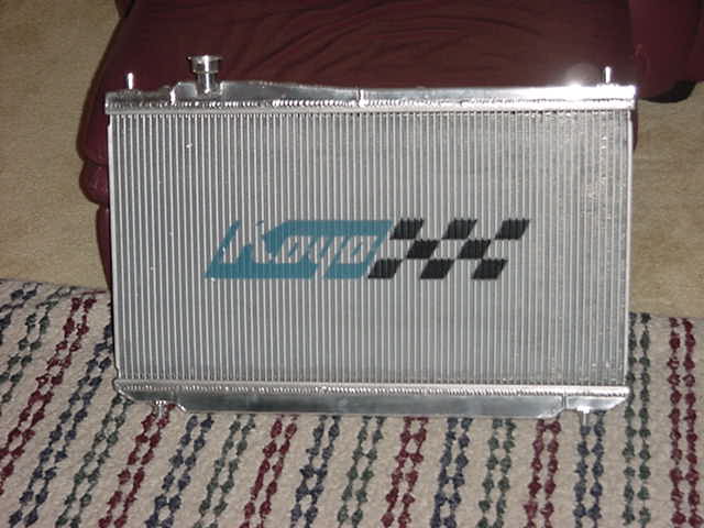

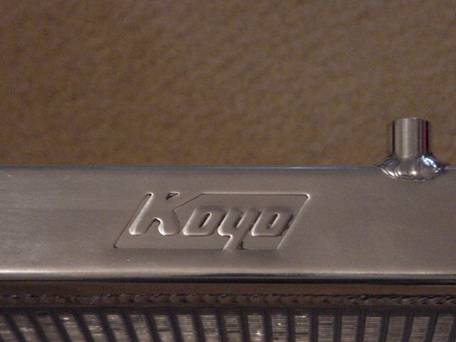

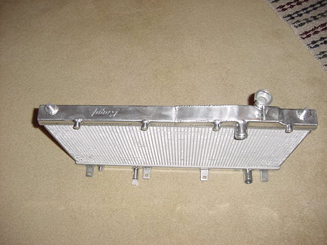

here are a few pics before I installed it...it would be be pointless to try to take pics of it installed b/c u cant see it from my bumper cover
Name:	Koyo Radiator #1.JPG
ID:	39088   Click image for larger version
Name:	Koyo Radiator #2.JPG
ID:	39089   Click image for larger version
Name:	Koyo Radiator #3.JPG
ID:	39090   Click image for larger version
Name:	Koyo Radiator #4.JPG

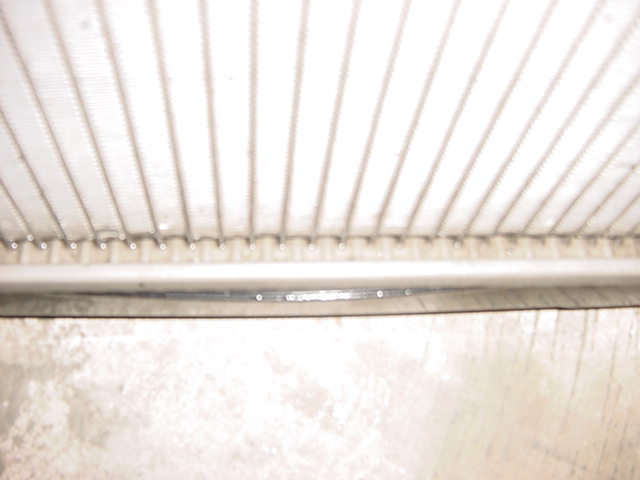

here's a pic of my BUSTED OEM radiator...u can see where it was leaking from...soon as your pour coolant in, it would come out right there at the bottom where the rubber part is separated kinda....
Name:	Busted Radiator #1.JPG
