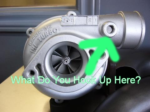

What plugs into that little hole there?
It's for your stash when the cops come.
I just went to home depot and bought a bolt and teflon paste to plug it. Its basically a vacuum / boost reference port.....
The only issue with using it however is that you may get a pressure drop from your piping and intercooler - which means your reading wouldn't be as accurate as if you tapped the vac line off of the intake manifold......

isn't there suppose to be a fitting with a hose there that hooks up to the internal wastegate?

Where do you hook up the manual boost controller?

in between that line i believe
between the wastegate and where the fitting is suppose to be

I doubt that tho...
The wastegate hooks up on the exhaust side of the turbocharger itself.. not the intake side.

the WASTEGATE ACUATOR

Yep. I know. But where does the boost controller sit? Does it sit on the vacuum line from the wastegate?

he has an external but still a wastegate
from there it is "T'd" in with the Turbo XS MBC and the Line going up to the manifold(vacuum line)

click on Vacumm hose and T fittings
http://www.beesandgoats.com/boostfaq...urbo.html#Tfit
