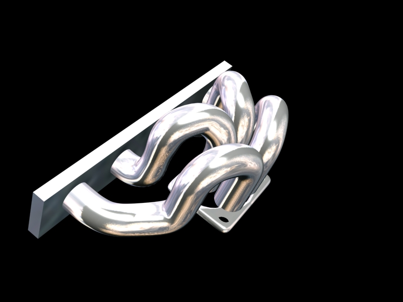

i know its soon but my friend that is making my manifold and downpipe just gave me some sketches he drew for what my manifold is going to resemble. he drew these quick and its just a layout.
the turbo is going to be on top of the header, yes this is different and i dont think any1 has done it b4 but thats okay!
also the manifold is going to be equal length

sounds good bro....... if you need any help, there are plenty of us here at 7thgen that will be willing to help you out.
btw, the turbo on top of mani won't work b/c there isn't much room there for clearance for the hood.........maybe you can prove me wrong

thanks for pointing that out, like i said its a sketch, we'll get measurements and see what we can do for the final product

also your downpipe will be long and will have to wrap around the mani to get to the exhaust.........this is why nobody else has put the turbo on top. Good thinking though

T25 turbo is going to produce very quick spooling power, but will be at a loss for anything over 4500 RPMs in my assumption. The response may be very "jerky" and "jumpy" as well, which is very typical of smaller sized turbos. True you will have minimal lag, but the lag is worth-while because after the lag is gone is when the surge of power comes. BTW, what PSI on a regular basis are you planning on running? The turbo may very well be operating outside of it's efficiency range based upon your PSI useage and driving habits. As far as the manifold, the HKS manifold is a very easy deisgn. The iron used is very dense and will take some abuse before cracking. It by far, is not the best manifold design for our car. The second manifold design is far more feasible than the first due to space confinements of our motor bay.
