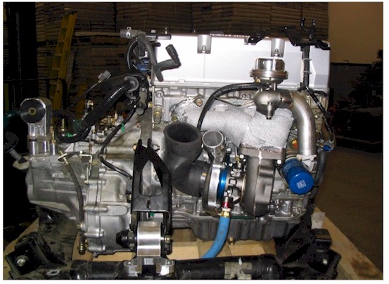

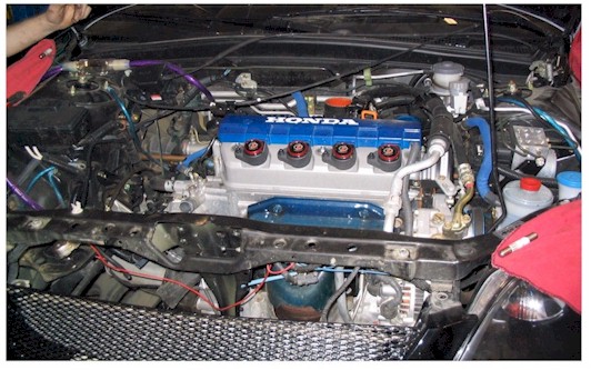

Here is the project so far and hoping to have it running by May 11th.
K20 preparation work
1. Quaif LSD
2. Vitek Stage 4 clutch
3. Plasma boosters
4. AEM fuel rail
5. Hondata intake heat shield gasket
6. Unorthodox Pulleys
7. Cybernation stage 1 turbo kit

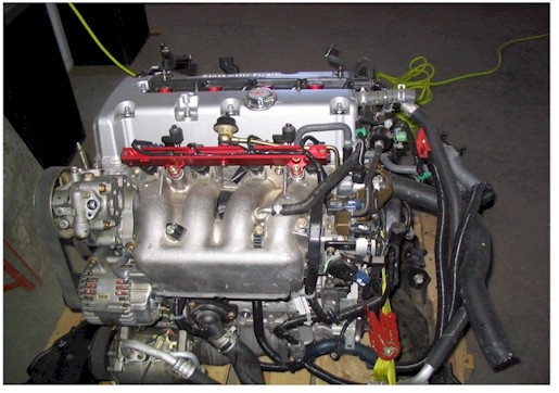

Pic #2

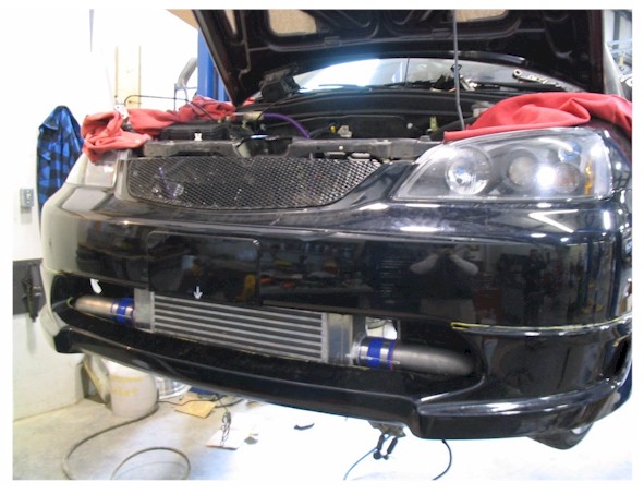

Cooling system:
1. Fluidyne 2003 Si rad
2. Scorrico drag dual fans
3. Spearco intercooler

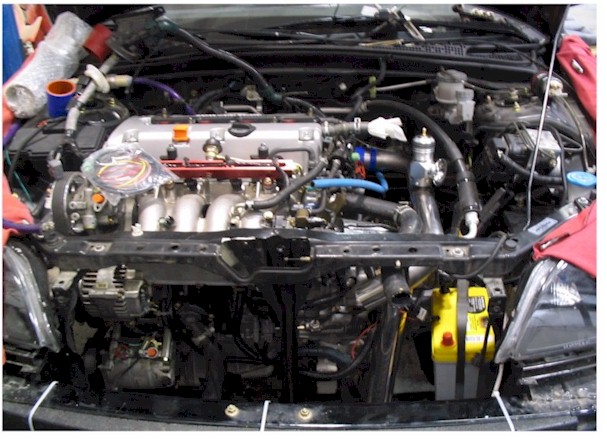

Will become

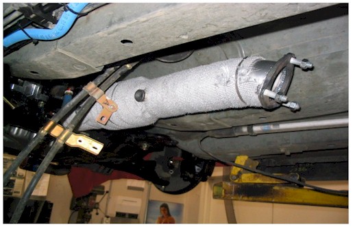

Coming soon:
Custom 3" Exhaust to a non-restricted Magnaflow muffler.

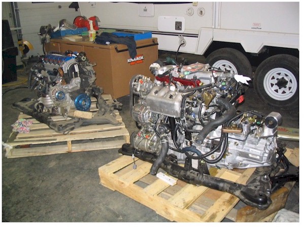

D17 vs. K20

Honestly the 3 inch exhaust is going to be too much. All the EP3s and RSXs that I've seen with CN kits make more power on 2.5 instead of 3 inch exhaust.

Poor jayson,
Is there any way you can take a pic of the clearance between the subframe and the 3in downpipe? I'm currently getting a new downpipe being made. I had a bad case of wheel hop on street tires. The downpipe was banging on the subframe reinforcements. I'm thinking of just getting a 2.5 flared to a 3in. I'm also getting stiffer mounts from hasport (77). The ones I got with the esk1 kit arent stiff enough. Anyhelp would be appreciated thanks.
BTW:My car is up in ny waiting to go in the shop. I'm stationed in nc. Which is why I can't take a pic myself.

Originally posted by icebergslim
Poor jayson,
I will see what I can do

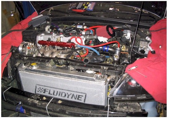

As of May 10th
