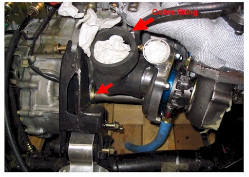

Can you talk a little about the modifications you've had to do to the Cybernation kit to get it to fit? Searched, and didn't find anything other than mention of piping.
1. If you drop the engine out (K20A2) and put on the exhaust manifold, turbo, oil lines (in and out) it is alot easier.
2. The cobra fitting (see pic) is a hard fit and the engine support must be narrowed
3. Waste gate dump pipe must be lengthened or routed into the downpipe. It dumps right by the oil filter
4. All intercooler piping must be altered. You have to run it over top of the intercooler behind the bumper not in front of the engine. If you run it in front of the engine you have to loss your A/C compressor and find a new belt.
5. Kit doesn't include many adapters (e.g. fuel tank)
6. Oil feed adapter to engine block will not thread, must modify.
7. Wiring straight forward BUT HASport has seen alot of problems with this set up and the wiring harness they have made. Contact HASport to correct problems.
8. The instructions are vague and necessary pictures are not included.
These are some but everyones will be different
Name:	106_0679 arrows.jpg

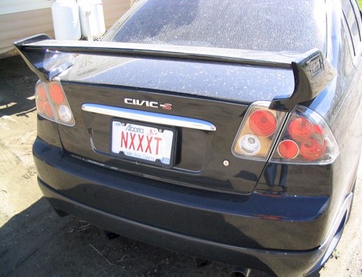

The new rear emblems
