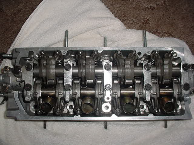

Wait - if the cam caps were loose than wouldn't it be whomever's fault that installed the head? Reason I say this is because they don't have the cam installed (usually) when they PnP a head - all of the DH heads that I have seen pictures of on here don't have the cam installed when they are returned by DH. If that's the case than whomever installed it fscked up. If DH sent the head back to you with the cam installed - than they are to blame for not torquing down the brackets to the proper torque.....

Yeah the head came just like this pic- plus DH had to put new valves in the head.....

If the head came that way - with the cam installed - than DH is to blame. They can't claim you were detonating, which caused the cam keeper to become loose, that's just plain BS.....

IMO, I think you have a bigger issue. Obviously the install was faulty since the cam caps are loose. This could have caused the cam to travel creating metal shavings. Or it could have been the head. If there were any shavings in the head during install, the shop should have noticed it and taken care of it. Any DECENT shop will inspect the parts given to them and make sure they are up to par (check water jackets, spring install, port work, etc...). Again, points to the install. Was it that? Who knows. Yes the head should have been clean. Is Hickman the primary person to blame here? IMO, no, the installer is.
