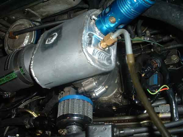

this is kinda on/off topic. but look whats newly fixed on my car. it seems to be a 2 week thing that something else breaks.. but oh well... my alcohol injector actually BROKE off the bonnet and so did my BOV. i duno how this **** happenes but OH WELL.
I had my boys down at NRG (turbo shop) close the hole up , then weld a thicker plate to the bonnet and then i had them thread it .
oh also i closed the hole for my IAT sensor cause it was causing boost leaks, now it just sits in the engine bay.
but look .. better then new

Originally posted by OsOBooSTeD
my thoughts exactly.
Take off the AIT sensor and put a small resistor in the plug. The ECU will think the air is cold and just put out more fuel. This is better than just leaving it hanging out. Search AIT mod on google to get the right type of resistor from radioshack. It works and have a 220hp dyno run at 10psi for proof.
yo bro.. good f-ing idea!
but what size...
all i can find is this...
A.I.T. mod (adding an inline 5.6k-11K Ohm
resistor to the "to PCM" wire from the sensor.)
