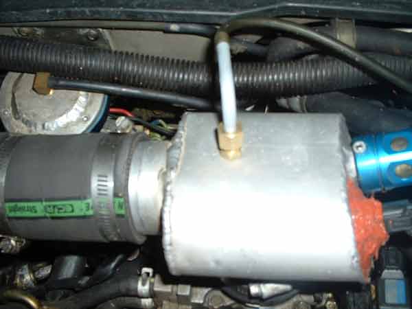

install the injector/sprayer... doesnt matter where.. just near the TB.. if the holes arent already tap'd then ull need to goto NAPA and buy a 1/8 npt tap.

^^^ btw .. that orange crap up there is what holds my IAT sensor in

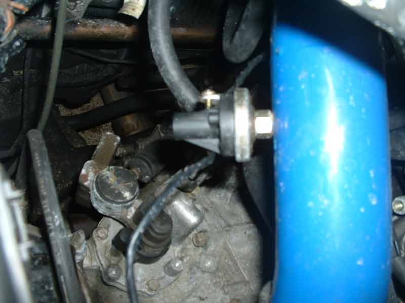

then install the pressure sensor... install this ne where BEFORE the injector.. i used the back of the elbow pipe...
run a wire from a constant power source...i used my fuse box... connect the wire to the pressure sensor.
then connect another wire from the OTHER SIDE of the sensor to the windshield wiper motor located on the tank(turn wheel and remove wheel wheel plastic crap to access)
i believe the power wire is the blue/white wire.. cut the blue/white wire and connect the wire from the pressure sensor to rest of the blue/white stripe wire still connected to the pump.
NOTE: this disables the use of the windshield wiper nozzles.
TO test :
take a piece of wire an connect each sides of the pressure sender... this sends a postive threw the wire connected to the pump and u should be able to hear the pump and see the nozzle spraying..
