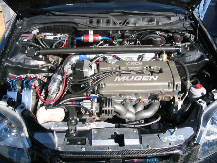

where does that get hooked up exactly? No offense, weapon-r isn't known for their quality, but you're still buying smart mods none the less....

here is a pict of two but i cant remeber where the lines go
