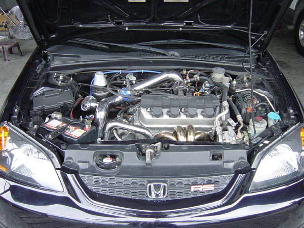

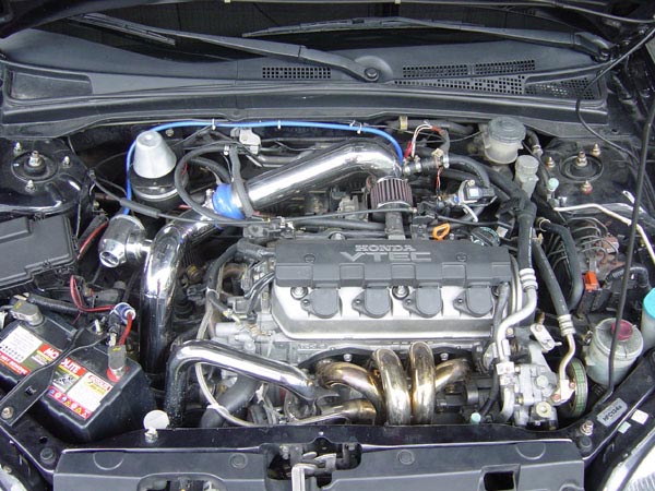

more pics. day shots
Old Dec 30, 2003
  #46
detoX's Avatar
Posts: 200
From: phillipines
detoX is an unknown quantity at this point
last pic. i know needs washin.

how come the manifold looks like that(looks awsome)??
Old Dec 31, 2003
  #48
detoX's Avatar
Posts: 200
From: phillipines
its called an equal length manifold, its suppose to reduce turbo lag..

sorry i meant the color....
btw equal leghts are cool..
Old Jan 1, 2004
  #50
Catalyst's Avatar
Posts: 3,071
From: Lancaster, California, US
Rep Power: 313
Catalyst is just really niceCatalyst is just really niceCatalyst is just really niceCatalyst is just really nice
it is stainless. That is what stainless does when it gets hot.
