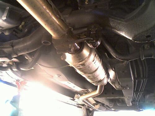

You have an LX though... that means with Ant's EX header, you'll need an EX downpipe and exhaust to go with the header.

Originally posted by AntDeezy
are the OEM EX header and the LX header different or is it just the way they mount up to the downpipe ?
LX header has the cat RIGHT under it--then that connects to the downpipe, the EX header just connects tot he downpipe, then the cat is somewhere in the back.
EX Cat.
There's no way you could put on the LX header with an EX exhaust unless perhaps you welded it.
There's no way an EX header would fit an LX exhaust. On top of that, with an EX header you're also gonna need the EX front sway bar and downpipe because the front sway bar doesn't angle as high over the downpipe like the LX bar. That's why people who did EX header conversions need the front bar - but as for the exhaust you need the matching manifold.
