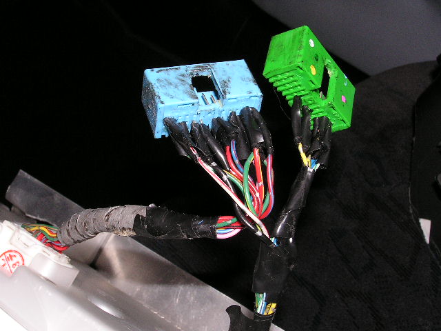

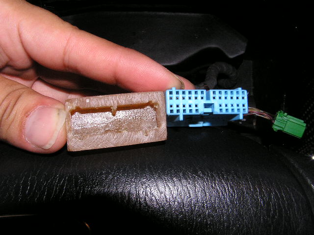

ok guys here what our plug is looking like, this is the harnes coming from the dash that we r trying to connect to get that pluge and play action...our new molded plug wrks, and fits nice and snug...all thats left now is to drill the holes out and pin it up...
buy the way this is the same plug that ruben jacked up...haha..thats why its so short...the ones will be selling will fit the lenth of the shaft on the oem plug so dont wrry about that...i just had to trim it down some yo make it look pretty

whoa cool

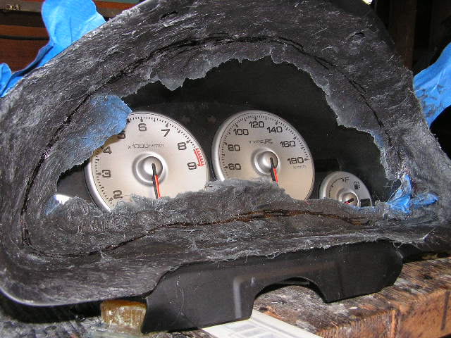

New update:
Tonight me and ruben got bizy....
haha...on the bezl that is, seems to be wrking out cool, used some kitty hair to bond to the OEM bezl plastic and shape to the RSX cluster plastic...that bitch has curvs like no other...i still need to trim and smooth it out befor i get started on the bondo portion of it befor i make the final product to make a mold off of. i would post pics but my dad took my digi cam to wrk so youll have to wait till tmrw to see what im talking about..
but just to let you know are project is near completion...now would be a good time to start collectiing your funds if you want to do this mod. also this would be a perfect time start looking around for you clusters, like i said i have one type r if anyone wants....

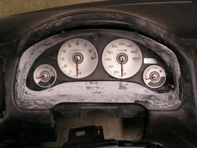

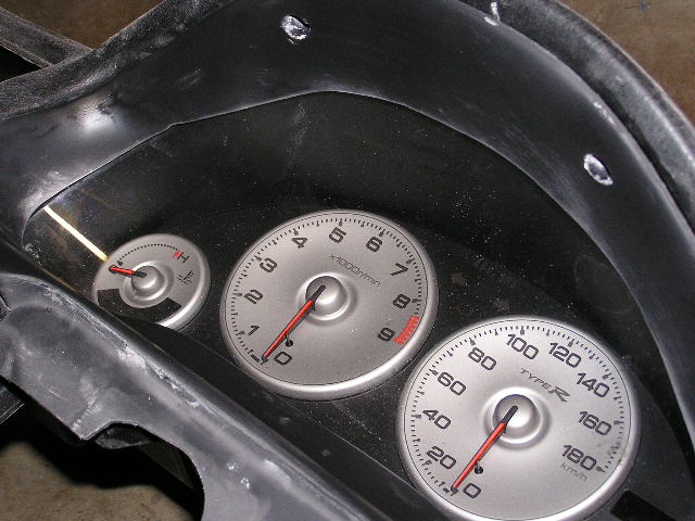

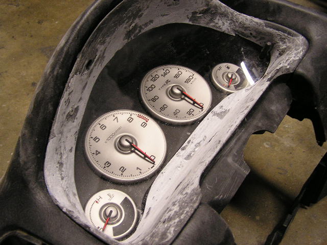

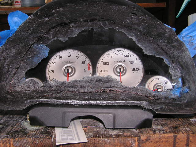

update: 7/28/04 RSX GAUGE CLUTER CONVERSION. NEW PICS
OK guys just got in from fabing the new bezl...took me about 5 hr to finaly get it to shape so ya some time was put in, its kinda like widdleing with out the wood..lol my fingers are raw from sanding with 80 grit...but here it is
these first pics are it in raw form after the curing of the kitty hair, looks like a mess huh...
these pics are of it after a few hrs of sanding and shaping...not an easy job, back breaking and skin ripping is what you have to look forward to when doing this..

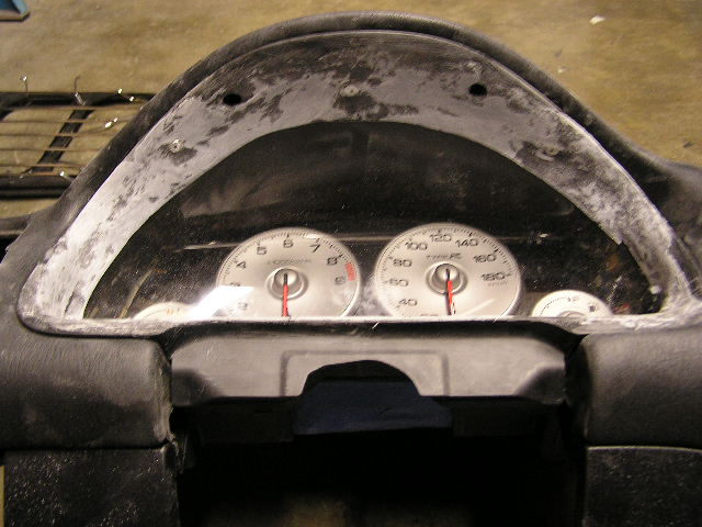

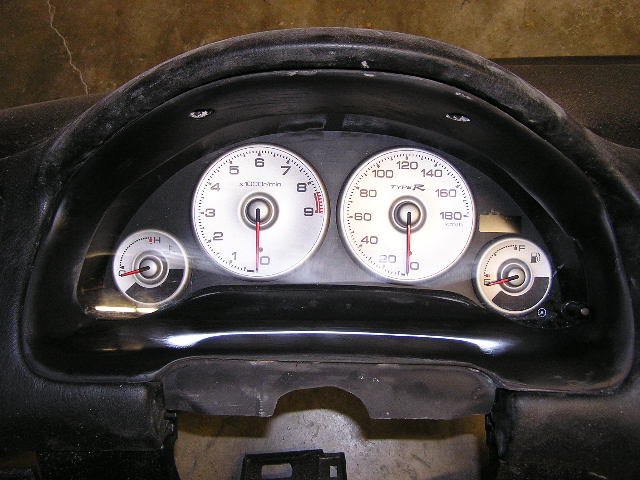

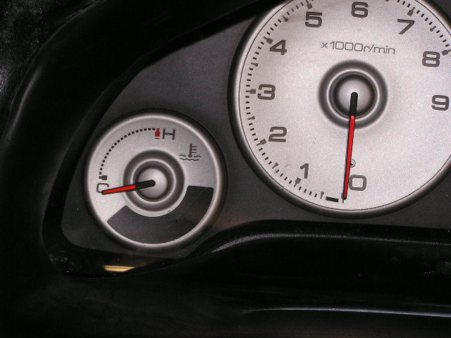

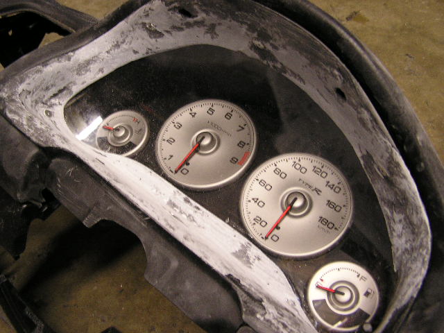

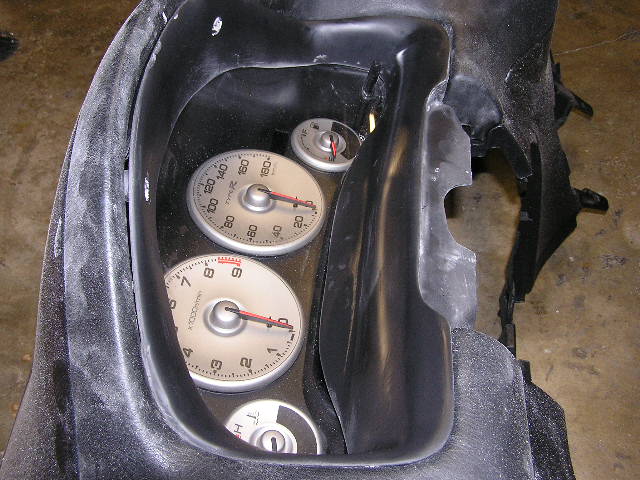

UPDATE: ok i spent some time tonight doing the body wrk on the new bezl, I still new to fine tune some pin holes and straiten up some crazy looking lines on the top left portion of the bezl. but it seem's to be coming out cool...
sorry about the pics they came out kinda dark because of the blk primer i used but you can get the picture, also the if it looks like it not lineing up right, thats because the cluster wsnt mounted to the bracket and was just siting in there for the sake of the picture..
what do ya think..?
