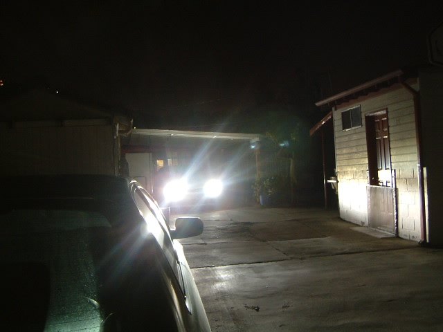

I need a place where they can adjust ur headlight beam cuz i just got HIDs and i tried and tried adjusting it but for some reason the left headlight still shines too much to the left and on to on coming traffic at night . Does anyone know how to adjust it correctly? HELP!

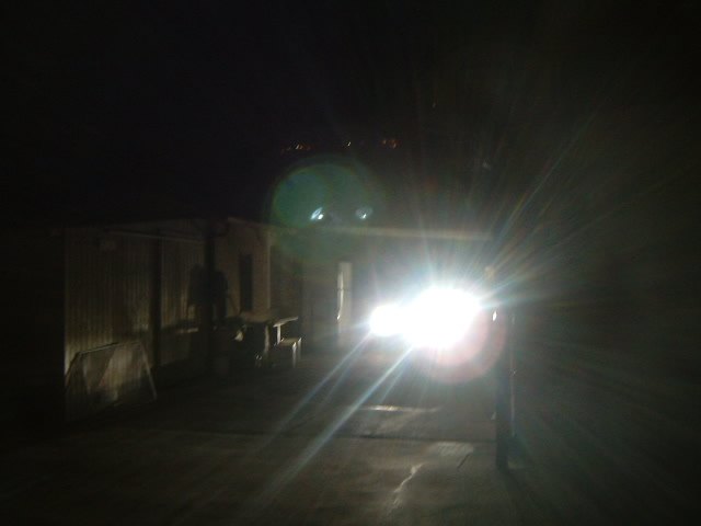

see....compared to this

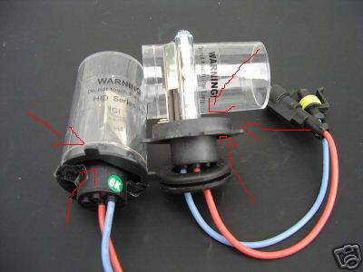

this is the bracket thing i'm talking about... this is a pic of H4 H.I.D. bulbs... the red arrows are pointing to the "bracket." i think thats the part you have to move and adjust to aim the bulbs...

how can you "adjust" the bracket you are talking about, when the bulbs go straight in. it's a fixed pattern, and they won't go in unless it's fitted in the right position.
what i think is...its because we are using our stock headlight housings with our HID's. no matter what, the beam is still gonna spread out a bit cuz of the way the stock housings are designed. if you think about it, practically all Factory cars with HID's use projector headlights (exception to the 2002 Acura 3.2TL). thats why all those cars have such a straight and forward reaching beam.
and on the other hand, my car's HID beam go really straight and also spreads out a lot. on the freeway, My HID's light up 3 lanes, my own and the two left and right. so yeah, they're obviously spreading out a bit too much.
anyway, ...my thought is it's probably becuase of the stock headlight housing. but if anyone does know how to adjust the beam, then by all means please enlighten us

if you look at the stock bulbs and other aftermarket H4's, you'll notice that the bracket part and the actual bulb are 2 separate pieces... that bracket can be moved to aim the headlights in a different direction...
if you look under the bracket thing on non-HID H4's, you'll notice little tabs in pairs... you can take a knife and loosen these tabs to get the bracket loose, then you can adjust it... then you'll have to find a way to tighten these tabs back up either using a pair of pliers or some other tool... once you put the bulb back in, you'll notice that its aiming in a different direction, depending on how you moved the bracket... or you can just leave the bracket loose, pop the bulb in, turn on your headlights and move the bulb around and see the direction of your beam move around... (i've done this before)
i'm not sure if HID bulbs are the same though... but since you have HID's, go take a look at your stock bulbs then you'll see what i'm talking about... i'm not talking about the actual 3 tabs that stick out that hold the bulb in place, i'm talking about the entire piece...
but of course they should already come aimed properly, but they only should be moved if they somehow got messed up, which is what i'm *guessing* happened to dru106's bulbs...
so either adjust the bracket or buy some new HID bulbs... for sure, new HID bulbs will be aimed properly..

I see what you mean now. But i took a look at an MTEC bulb, like the one you have pictured. the 3 ring thing, and the bulb are indeed two pieces, but they are welded together by little tiny tabs. i guess if i really wanted to adjust (rotate) the bulb, i'd hav to break the tabs, then continue to solder the tabs back on until i get it right. thats pretty tough. i haven't looked at my HID bulbs yet though.

but yea... if its welded, you would have to break it,
but the hyperwhites i had before weren't welded and became loose and ended up being aimed high, but yea it is tough, because i wasn't able to get it on right... the bracket was still loose no matter how hard i tried to tighten those tabs... in the end i was like f*ck it and just got new bubs and tossed the ones that were aimed all high...
