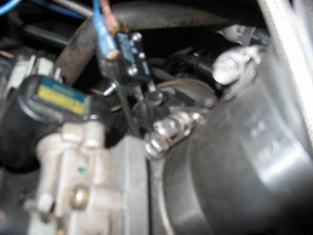

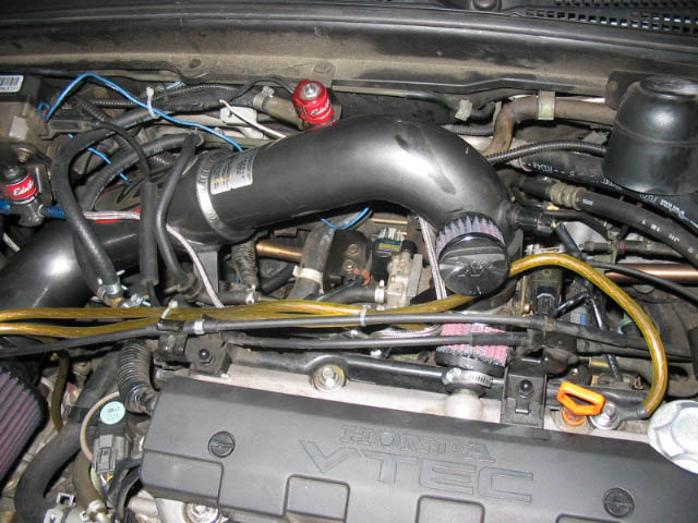

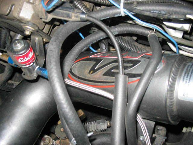

look man, the only tuning you can do with it without a computer/ecu is basically just try different jetting sizes. For instance, my nitrous jetting i s .035 while my fuel jetting is .029 if Im lean I would simply just unscrew the nozzle and put in a higher jetting for the fuel to make more fuel go in so thats the only way I can tune my **** for now. The manual even says to know the a/f ratio so you can adjust the jetting sizes. Of course the manual told me how to start but its not accurate so you would have to change the jettings yourself and test it to be sure that all jettings are proper sizes.
Tuning nitrous is nothing like tuning a supercharger or turbo.

Yeah I know nitrous is dangerous. And Im learning more and more things through experience of trouble shooting. Luckily edelbrock was always there to replace my items for free in some cases they gave me extra stuff for free.
My kit is direct port style. Thats what it says in my manual. Its not actually direct port. Its like saying carbon fiber style which is not really carbon, but has similar patterns to it. The real carbon fiber is the real d eal while carbon fiber style is just alike.
Once again ive also tested my car against an accord v6. I killed the v6
