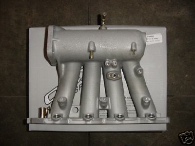

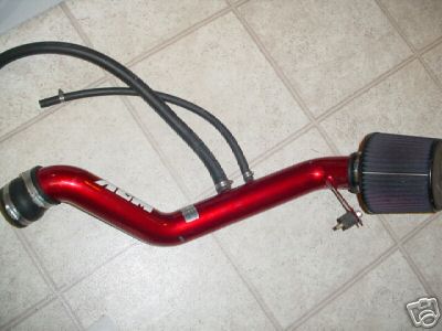

Originally Posted by Civic_RedLine
j/p the nozzles are squirting inside the manifold.
sure....
intake
intake manifold
big difference. how many jets are you running?
ID:	47222   Click image for larger version

u mean the size of the jets or the fuel and nitrous jets.

no how many jets do you have period.

mines is direct port style. only 1 set man. It goes into the rubber clamp that holds the intake into the hole. Its the best way to spray for my set-up.

and this runs MORE than an 80 shot? lol. anything over 75, and generally wet nitrous systems are 4 port direct nitrous systems with 4 nozzles. why? because above 75 shot, the mixture will not atomize the fuel properly and evenly with only one jet, and will cause detonation in pistons.
