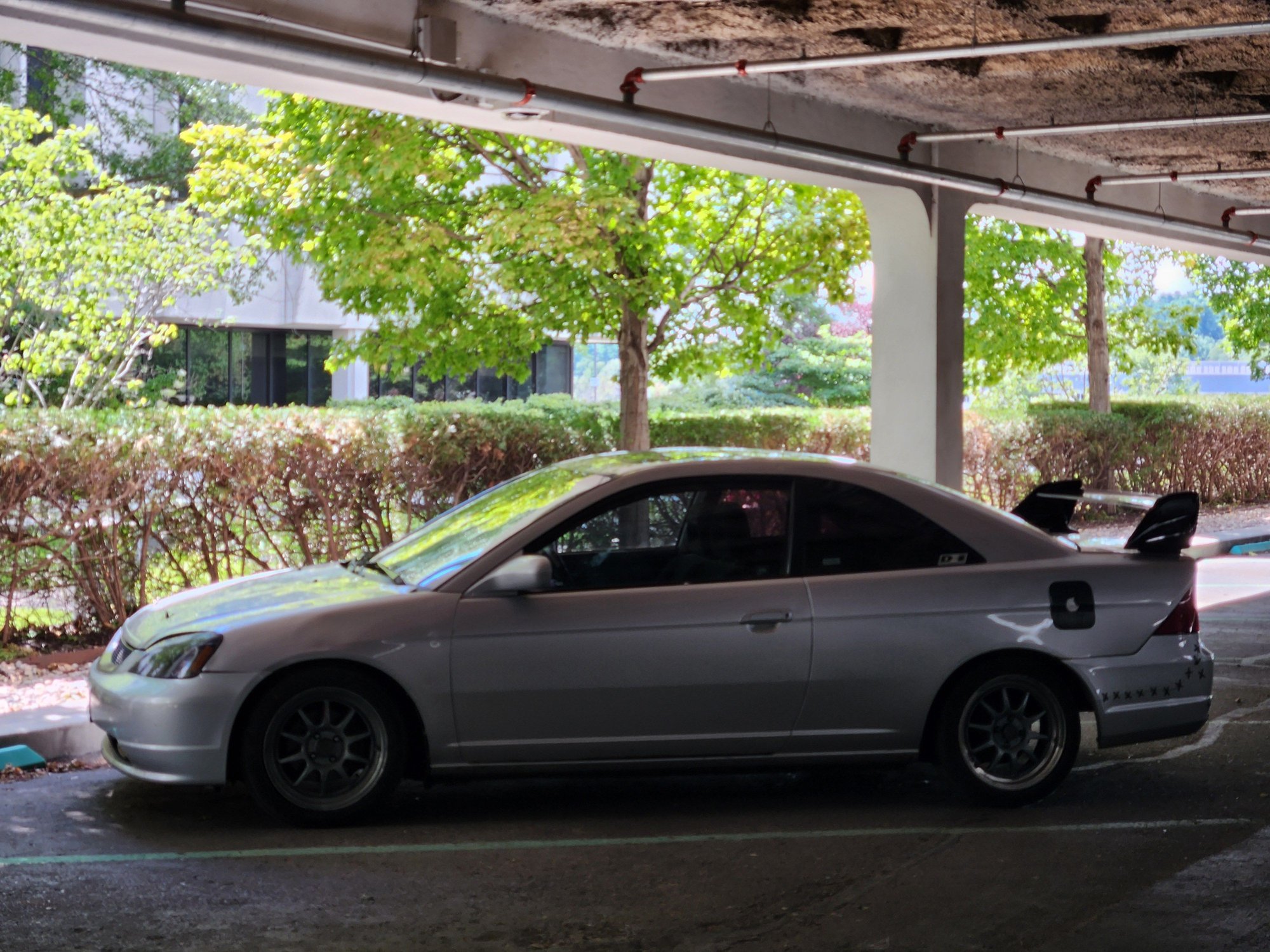

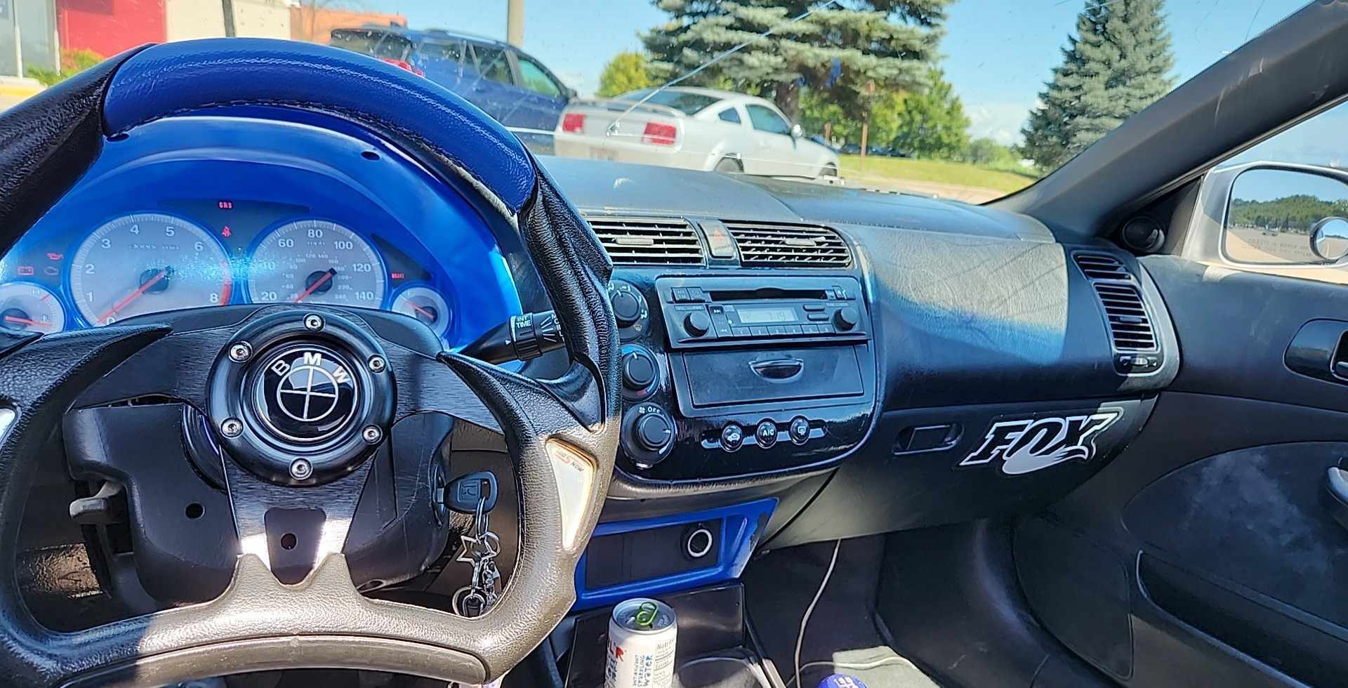

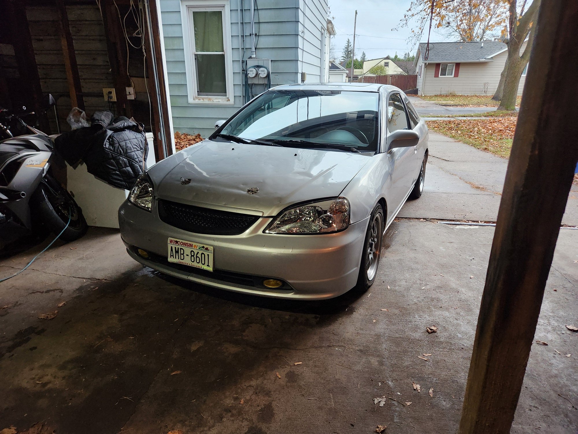

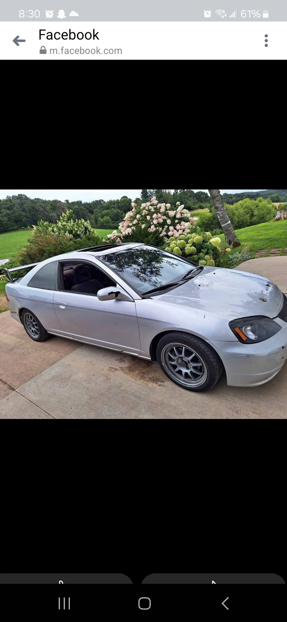

Aaaand here she was the day we met. As I mentioned, Vicci is a manual 2002 EM2 EX with a whopping 265k miles that had apparently suffered through a gauntlet of teenage boys modifying her. I didn’t know much about seventh gen Civics, Civics generally, or even Hondas at the time, but I knew people really liked Civics and heard they made a great platform for a lightweight, economical daily and that’s what I want. When I saw the marketplace post, I sorta fell in love with how campy and goofy some of the modifications on this car were. It felt like it was modified on a tight, tight budget in the era of the first few FaF movies. It had:
  • A big goofy wing that was beaten to ****
  • Autozone tint on the windows that was peeling/ripped in several spots, plus had the ‘shocker’ in the rear window
  • Interior trim that had been poorly spray painted twice without stripping the original layer (blue, then black)
  • $15 amazon “””””BMW””””” steering wheel, which deleted my cruise, airbag, and clock spring
  • Rota’s that had been plasti-dipped grey at some point, which was now peeling and looked like ****. Dented af
  • An amazon tachometer with all the wires exposed drilled into the a-pillar trim. A perfect compliment to the factory tachometer, which the car also had
  • Ebay lowering springs
  • A severe lack of a muffler, to go with the missing bolt on the header to downpipe flange
  • Tinted aftermarket headlights so that they work less as headlights
  • Hood pins, since it no longer had the hood latch after a front end collision
I’m sure the list went on. She was a hot mess, but so am I. I realize asking a high mileage, poorly maintained, and poorly modified Civic to be both something to lightly tinker with AND a reliable daily is a recipe for disaster. I can’t really explain why I did this other than “sometimes you need to do something stupid to feel anything at all.”

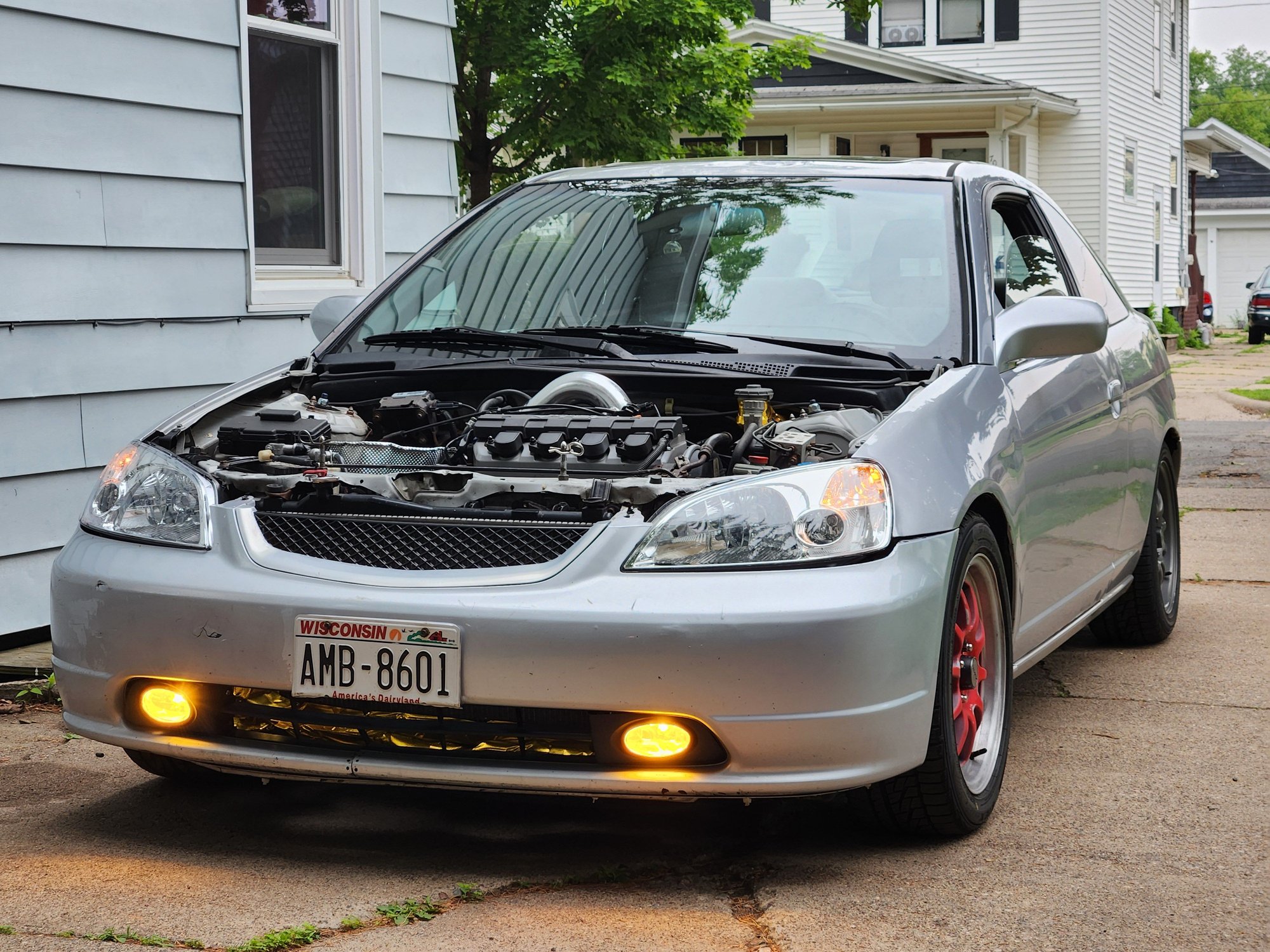

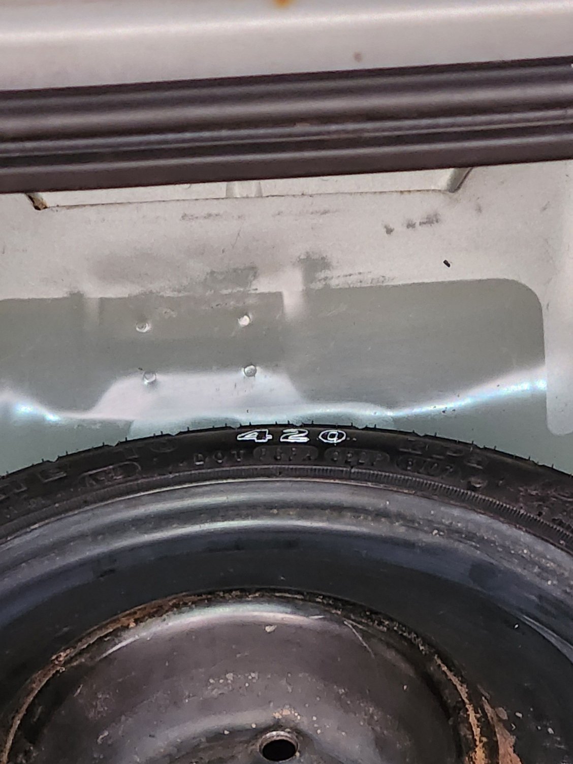

Now that you can see her, a few things to note: it has pretty righteous hail damage, as well as clear front AND rear end damage, rust starting on the rockers and wheel wells, and a shattered windshield. I couldn't tell from the pictures in the post, and because I'm kinda shy and a push over he wanted me to sign the title right away and kinda rushed me so I didn't give it the best inspection. It just seemed to run fairly well, and even if it was ugly I found it charming. But no doubt I got taken for a ride, even with how little I paid. Stick around to find out how!
The last picture in the above set is a close up shot of my power steering pump. I hadn't noticed this fine bit of craftsmanship until I got her home and started digging in. Concerning as it was, it had somehow done well enough for a four hour road trip as it was (whatever exactly "it" would turn out to be). Surely a bad omen on things to come.

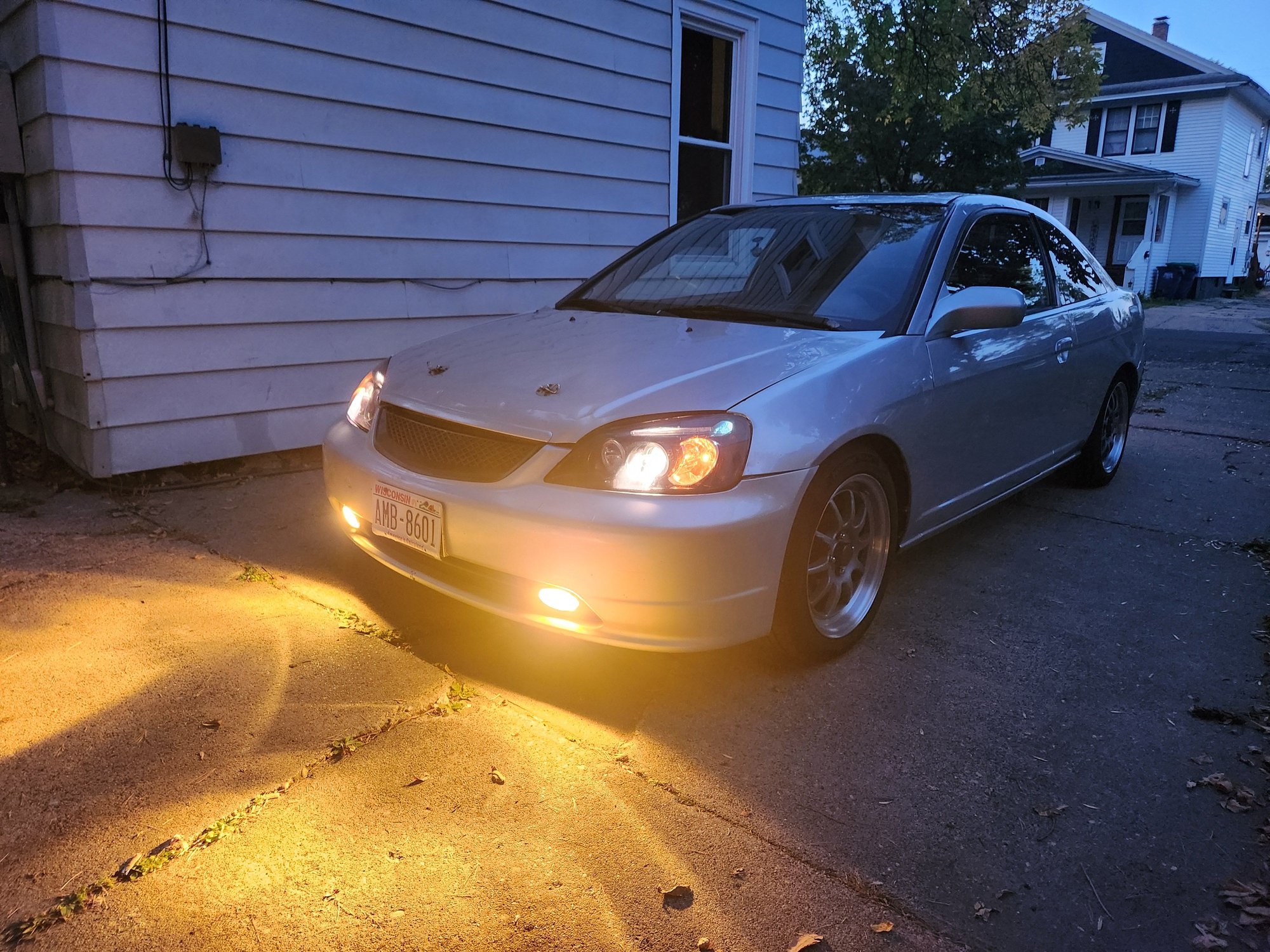

Next up, something fun and cheap as a reward for fixing that mess. The car came with some really beaten up hella-yella aftermarket fogs that didn't work that I kinda liked the look of, and figured I could find a cheap kit from ebay that would cut it.
With the bumper off to replace the old units, I got a good look at the front end damage. Ugly af, but it's all in one piece. It was at this point that I figured two things: I will surely be this car's last owner, and I'm sure she'll never drive 100% straight. Best case scenario is she eventually retires from daily duty and becomes a track rat in her twilight years. But for now she's going to be road worthy.

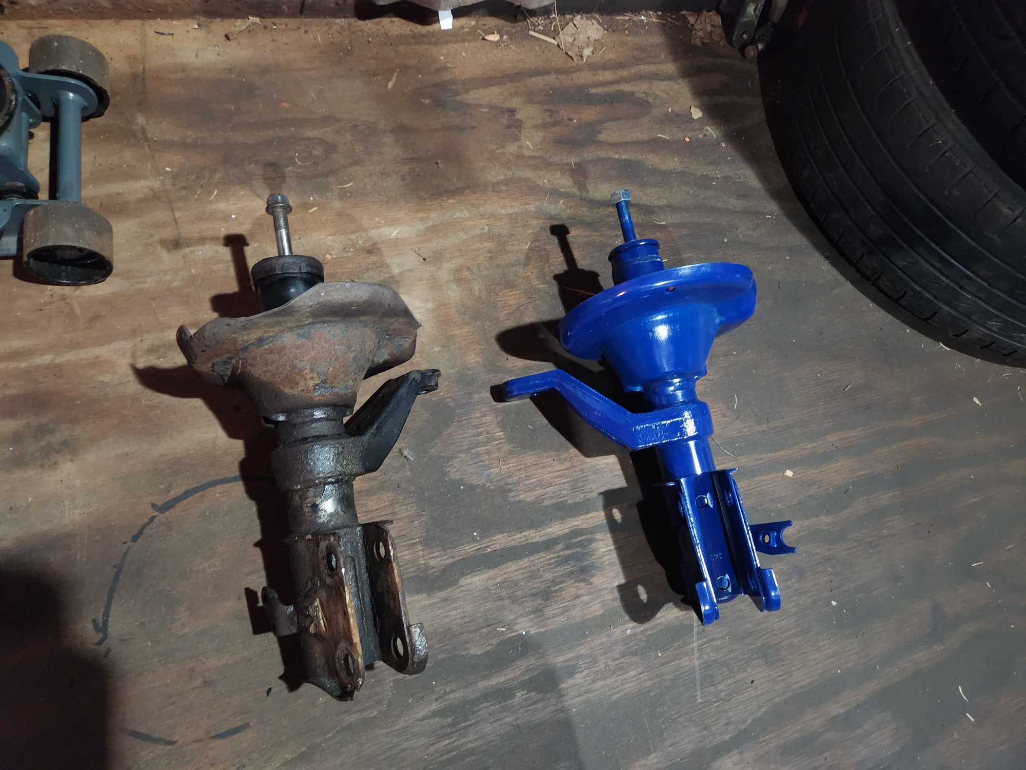

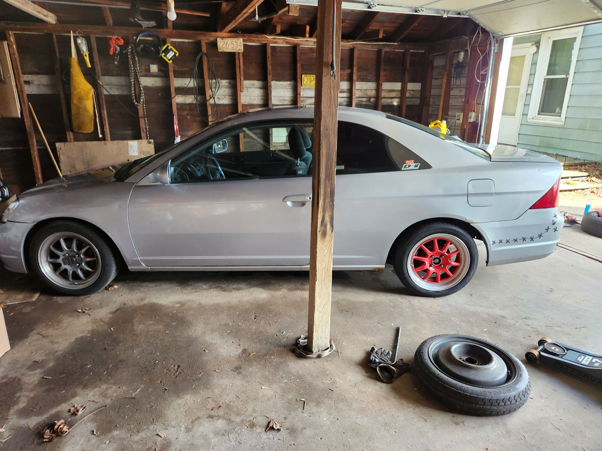

Next, I took off all the wheels and inspected the suspension. They had no name red painted lowering springs with original front shocks and old Koni's in the back. They didn't feel good, but they weren't blown so they would do for now. All four sway bar links were shot, and two were completely separated so I replaced those and the car immediately felt 100% better. The control arms were old and bushings were on their last legs, so I would replace those one set at a time. One gave me quite the challenge, but I'll get to that later.

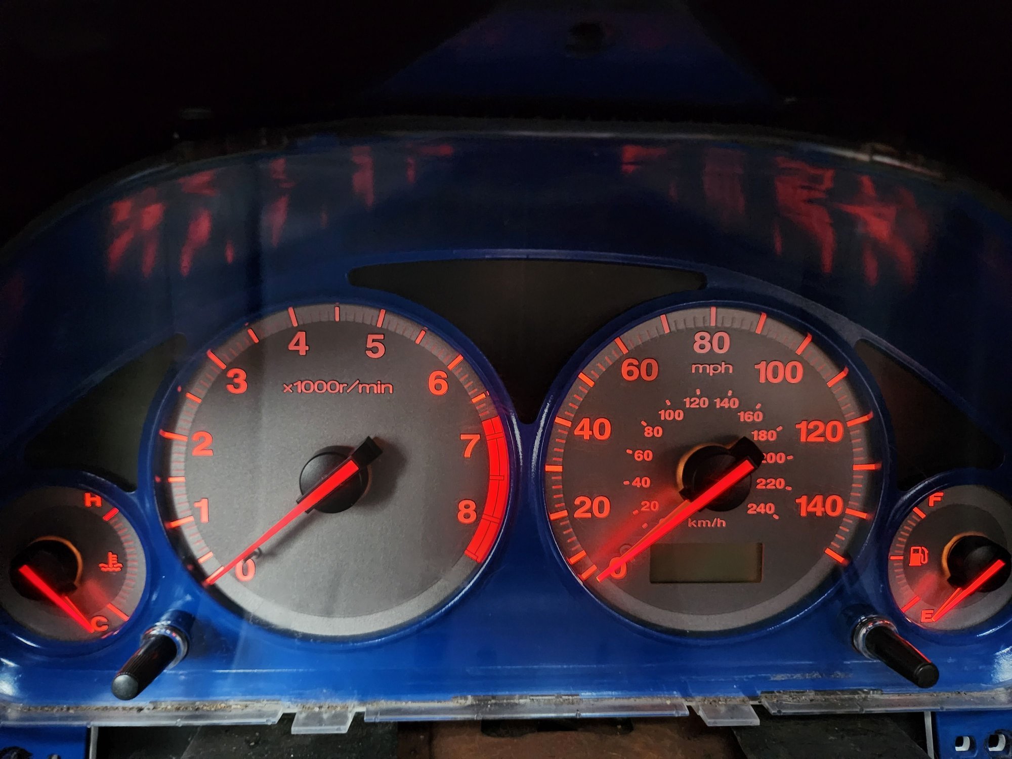

As the months went on, I clean a few things up like replacing all the burnt dash bulbs (peep the horrid blue dash -- that would also eventually get stripped over the year), removing the black paint from the gas door, and finding some clear lens headlights from ebay that have been holding up pretty well so far. Of course had to get the classic civic rear lower control arm/brace combo, so I went brushed aluminum to match the car's color pallet. Also deleted the wing, it was just too much for my taste. Evidence that this car was modified in the early Fast & Furious era.

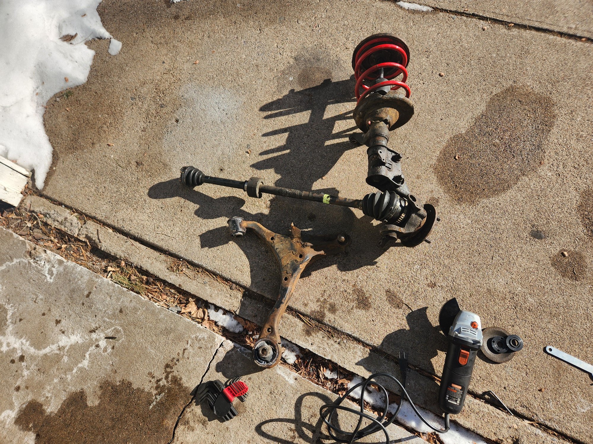

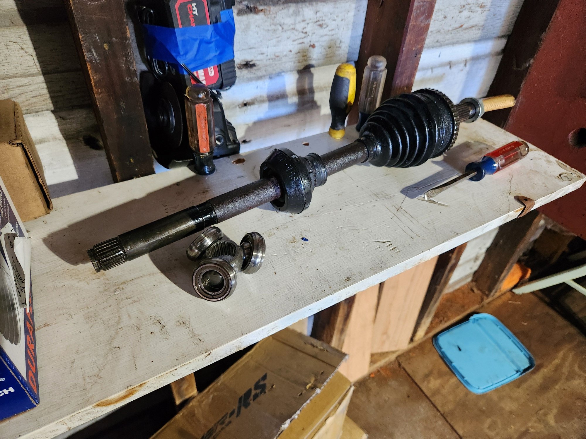

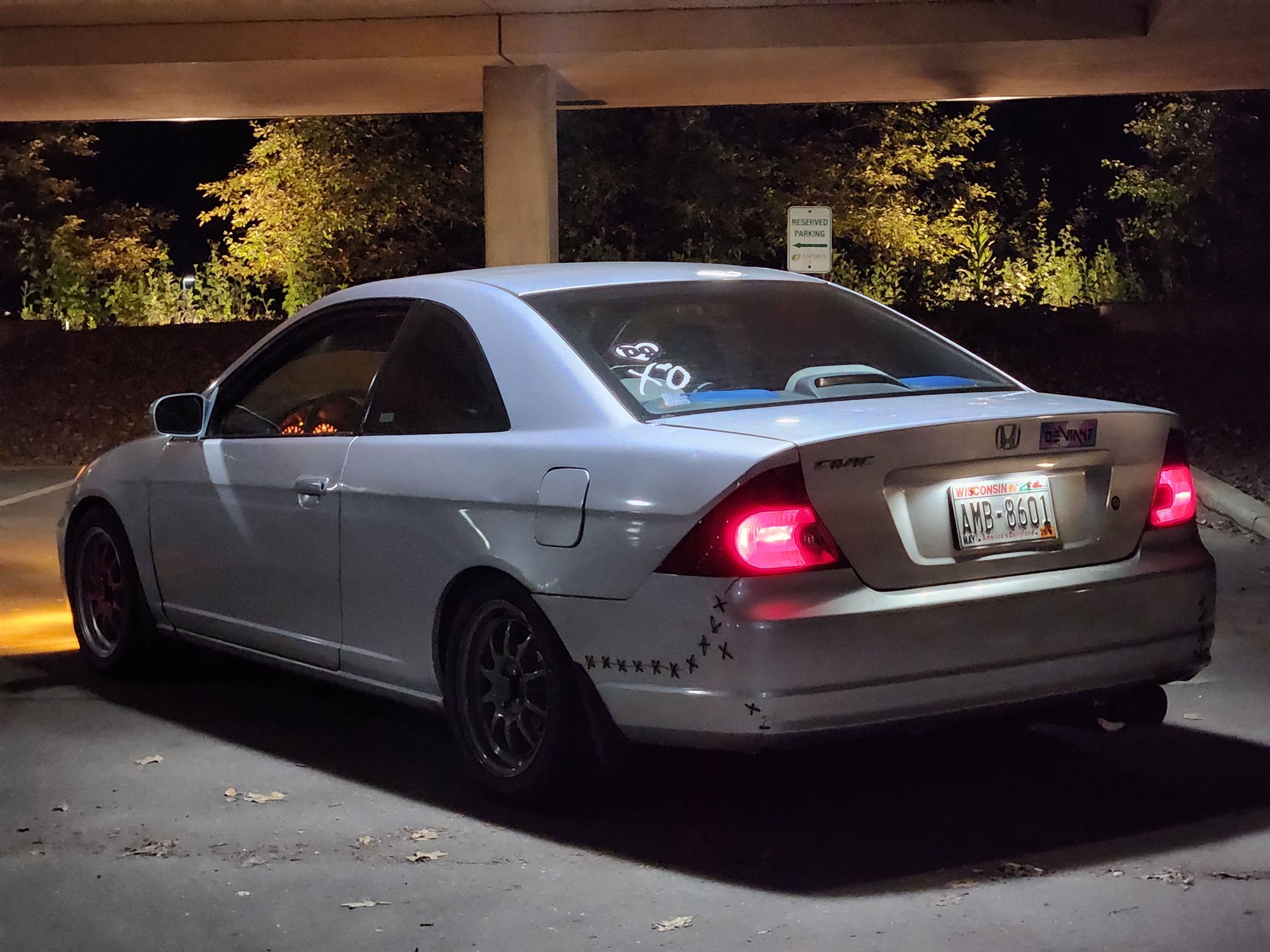

This is the end result of an absolute mess I got myself into. Perhaps the end result of hubris in the face of the sublime power of Midwestern rust.
Originally, I was just going to perform a simple FLCA replacement to get some new bushings and un-rusted arms in there. Mevotech's Supreme line uses solid rubber bushings instead of ones with gaps like oem and firm up the ride ever so slightly compared to stock -- decent budget upgrade. However, while trying to separate the ball joint from the LCA, the ball joint ITSELF separated. That is, the ball dislocated itself by breaking the socket. Oh dear. Not only was I not prepared with parts and tools for a normal ball joint job, but because I was in the middle of a different job when the joint broke I was kinda out of order in my steps. To remove the ball joint from the knuckle, the only way would have been to separate the axle from the knuckle to fit a C-clamp type press to press it out. However, because I hadn't loosened the axle nut before hand while everything was stable, the amount of free movement in the remaining assembly was too much to hold still for me to get any real torque on the nut. This left me with no real way to remove the axle, and so I was unable to remove the ball joint.
Since this was quickly getting expensive with buying tools and parts and leaving me without a car, I thought long and hard and decided on the following: I would leave the strut, knuckle, ball joint (or at least 1/2 of it), AND axle all attached, unbolt the strut from the top, remove the axle from the trans, and replace the whole **** with parts from RockAuto (shouts out, shameless shilling for the cheap parts GOAT). It was a long shot and a big job, but being a home mechanic and fighting with this for two weeks left me without any other options. And it worked! New pre-loaded knuckle, axle, LCA, and ball joint on the passenger side. I ran out of budget to replace the front shocks at the time, so I took an angle grinder to the shock-to-knuckle bolts to free it and reuse it for the time being.
Post-repair test drive and shakedown on some midwestern backroads went very well, everything felt very tight and rode very smoothly without noises (some noises were even gone). I was a little worried about all the new components all being correct spec and assembled and torqued correctly, but I took my time and followed the manual, and things turned out great. A little gumption and thinking outside the box combined with going slowly really did the trick in the end. Good learning experience for me as an amateur mechanic.

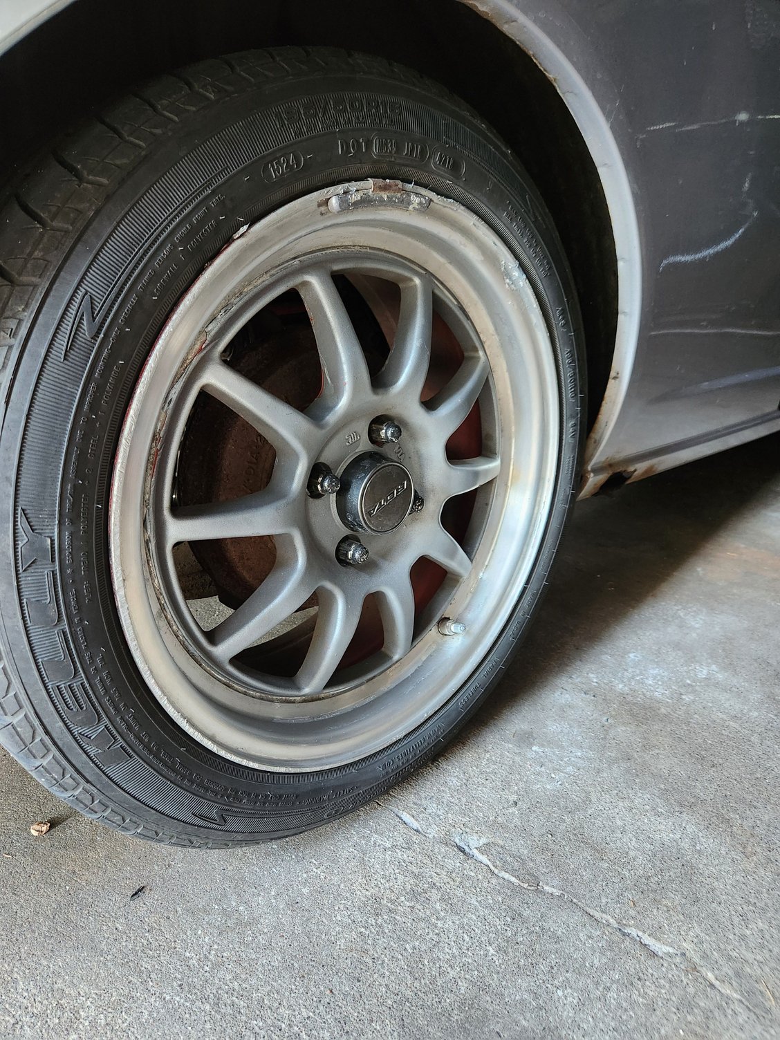

Okay it's time to address these wheels. They are 16x7 Rota GT3's, and as I mentioned earlier in my posts they were beaten to hell by the time I got them, were very poorly plastidipped grey (peeling quite badly by this point), and were wrapped in absolutely trash tires. Not knowing if Vicci would last long enough to be worth it and also being a broke bitch, replacing the wheels wasn't in the cards quite yet. However, tires are a safety item and make a massive difference in handling, so I decided to get new 205/50R16 Faulken Ziex ze950's on them and I'd give repainting them a shot. The tires got good reviews online for a budget daily enthusiast tire and were in budget, and I really don't care much about these reps. Alright, let's see what's under the plastidip:
OOF.
So here's what was underneath. Unfortunately because I didn't have a spare set of wheels to use while painting and I had to drive around restocking on painting supplies as I went, I painted them one at time over the next few weeks, rocking mismatched grey and red wheels the whole time. Now to each their own, but I think the red is hideous on this car so that was painful hahaha. Anyway, here's the finished product:
The paint is maybe a 6.5/10. I really took my time with taping, prepping, sanding, and used 2x base, 4/5x color, and 3x clear coats. I'm a pretty novice painter and was working with rattle cans and painting outdoors so there are certainly plenty of imperfections. But mostly they have a decent gloss, good coverage, and look 90% better than when I got it. Not my first time painting wheels, but every time I do it I learn a lot and get a little better. I also wanted to try the wing out again to see what I thought after a while, but I decided I was right and didn't like it still and would soon take it back off.

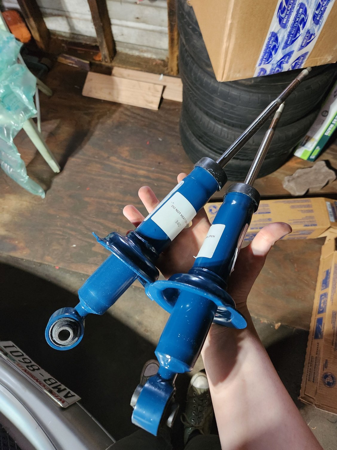

Monroe had a serious closeout sale on oem spec shocks on rockauto at the time, so I scooped up all four corners for like $50. I wanted to get sport shocks eventually, but figured this would help immensely in the mean time. And they did! Crazy good deal. That's also my AC accumulator (I think). It was the last part of the oem AC system still in the engine bay. The boys that owned Vicci before me had ripped out or destroyed most of the oem lines, compressor, and condenser, so I just finished the job to clean things up. Oh well, not every car can have AC I guess.
I didn't take any pictures for this, but I also replaced my front discs, pads, and calipers with oe spec stuff as well as new fluid at some point before all this. The old units were burnt, thin, leaking and seized. Super cheap on this car, and god did it make a difference. As with most things I've replaced in the car, my main goal (while this car is a daily driver) has been to make the vital systems of this car work as oem intended, while upgrading/modifying little things along the way to hopefully improve it's capabilities a little when I want to go rip around back roads.

Axle boot on the side I didn't replace was torn, but still had plenty of grease, so I opted to rebuild the axle. Cool learning experience, I feel confident doing it again. I know a lot of people say reconditioning oem parts can be better than buying aftermarket in some cases, and I tend to agree.
