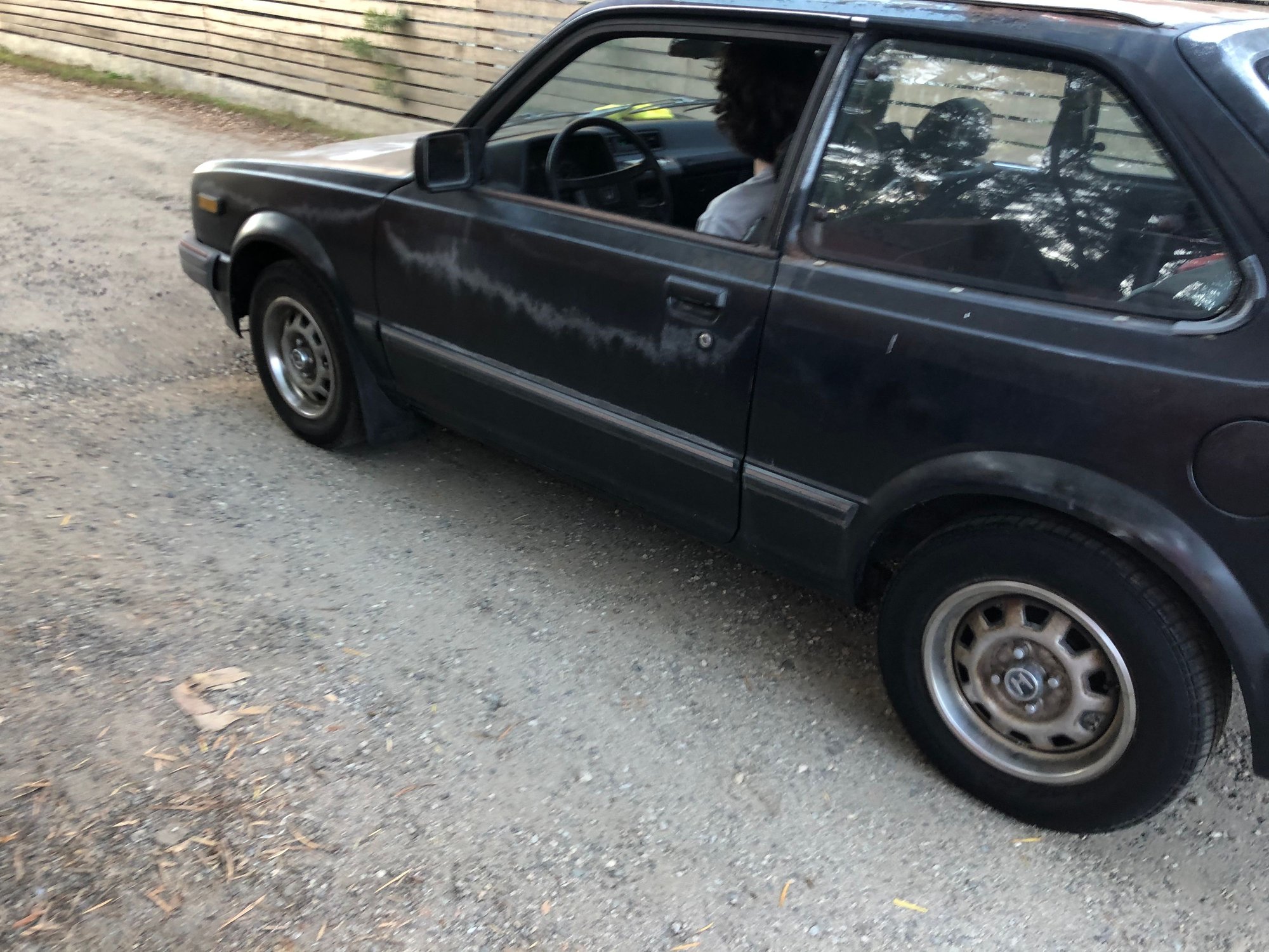

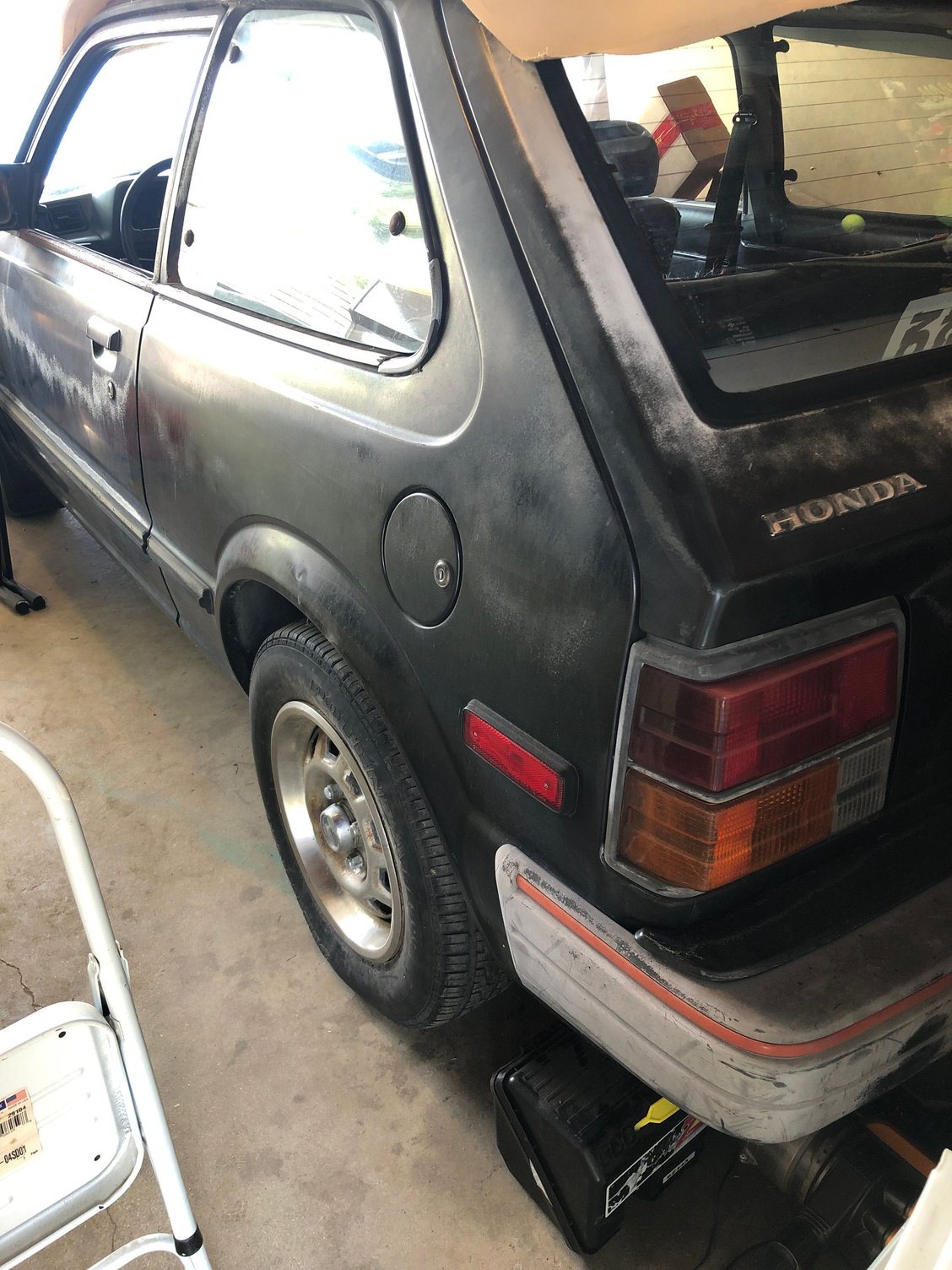

Old Jun 20, 2020
nayrbgo's Avatar
Joined: May 2020
Posts: 10
nayrbgo is an unknown quantity at this point
Re: New to the forum -- have a 1983 3 Door S
Old Jun 20, 2020
nayrbgo's Avatar
Joined: May 2020
Posts: 10
Old Jun 20, 2020
nayrbgo's Avatar
Joined: May 2020
Posts: 10

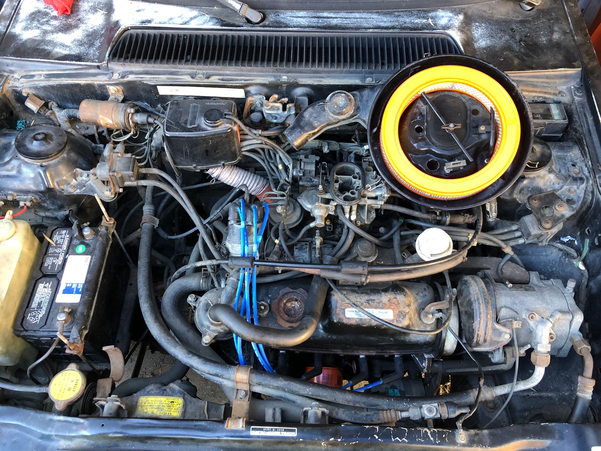

I have been reading a bit -- I think that we might consider replacing the carburetor, the spark plugs, and the spark plug wires. Does that sound correct? Any other advice?
And if you have any leads on getting parts, I would love advice on that as well.
Thank you!!

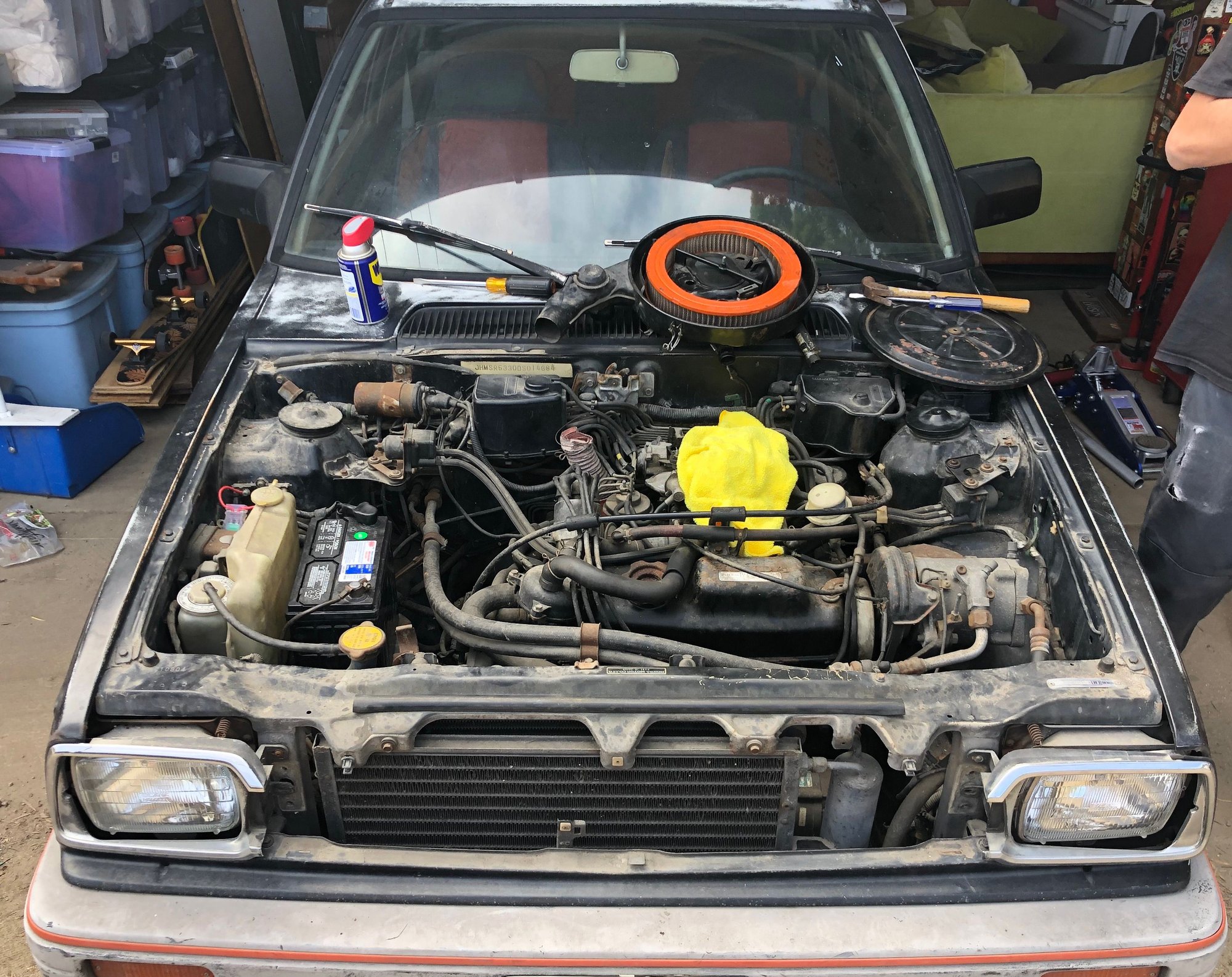

We replaced spark plugs, spark plug wires, oil filter, oil, and air filter -- we have a new battery on it, but it needed a little jump since we haven't used it in a while.....
and we got a start!!
Please see the video (attached to this post).

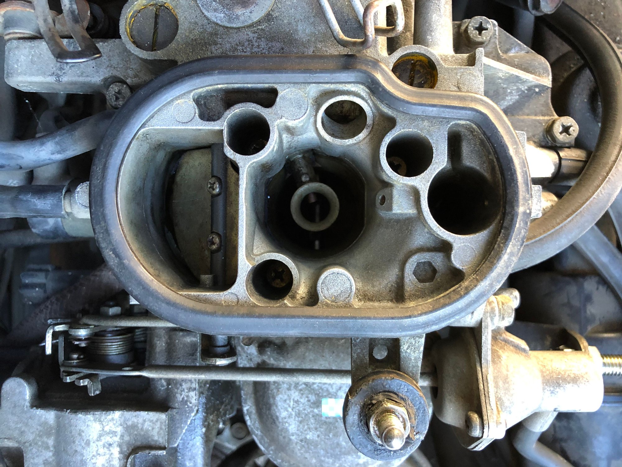

The throttle linkage is stuck so that the engine revs to over 5000rpm! and so that is the next project. Any advice? Thank you!

Congrats! It sounds pretty healthy.
Penetrating oil should be able to free it up. Let it sit for 10-ish minutes then open/close the throttle about a thousand times (you may need to use pliers). I've had lots of carbureted bikes with the same issue and that's always done it for me.

Update! We got the carburetor rebuilt -- and tuned up a few things. The car runs! The engine can idle!
