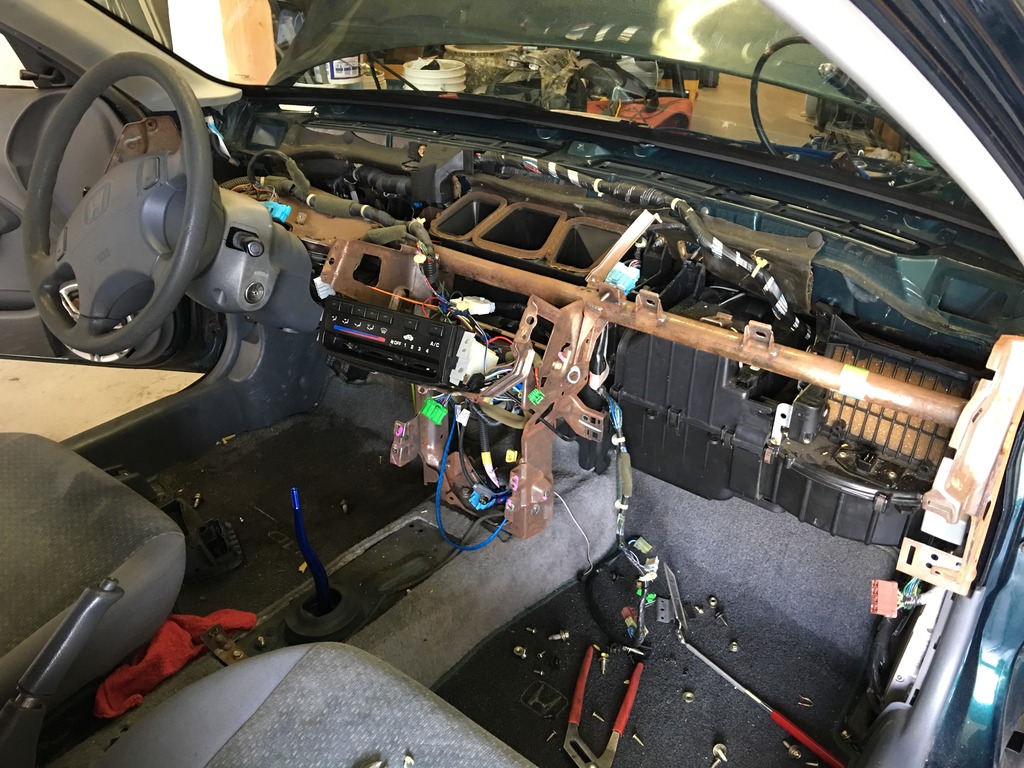

HEATER CORE IS POPPED!
I just learned how fun it is to replace yesterday (sarcasm). I will have a youtube video of it when completed.
Also F U Autozone! I was in there for like 2 hours getting a freaking core that I ordered... so frustrating.

New core is in. NO spark!!! wtf. I must have tore a wire or forgot to plug something in. I did put pretty goos amount of stress on the wiring during the R2.
What are the 2 green plugs (G collar on loom) under my dash in the center? I could not find where they went to. They may be the issue. Otherwise I am going to have to take the dash back off and see what is failing.

So I forgot to plug the main relay on the right side of the dash support. I plugged it back in and it works fine. Now I just have to find what's making it ping. I am starting with the spark plugs. For now I fill it with premium and it reduces the pinging a bit...
