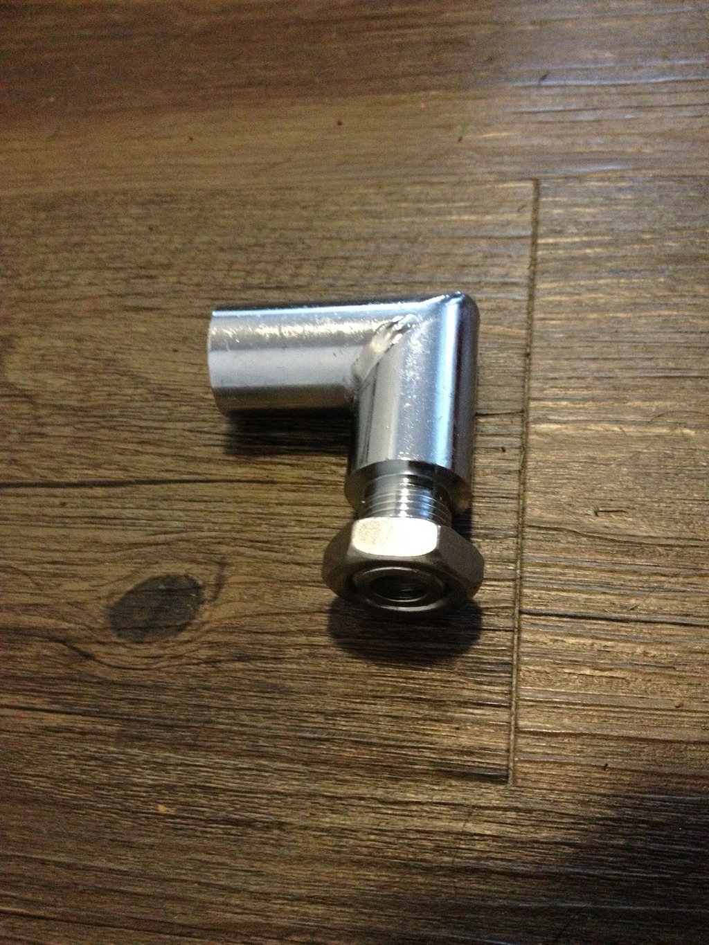

It finally got here from 3000 miles away, so I won't have a check engine light anymore!...

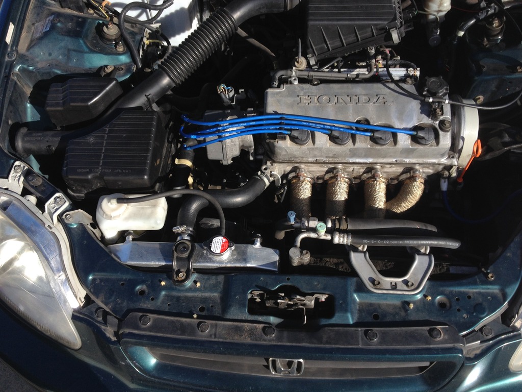

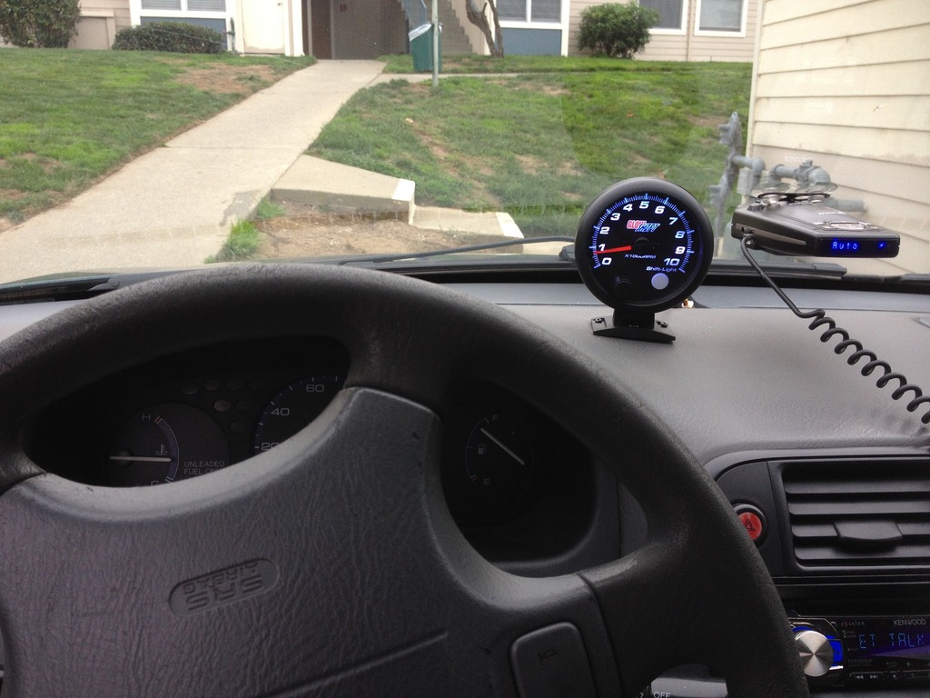

I got the Emulator installed today, I had to bend the header to the left so that it would not hit the axle shaft. I cleared the codes and the O2 code has not come back.
I also wired the Tachometer, it is really cheaply made, but it is kinds cool with the ability to color change the backlight. I haven't figured out how to set the shift light.

I figured out how to set the shift light now. I set it to 5k because that is the top of the torque curve and this car has no top end power. I know redline is 7100 rpm and power curve is around 6500rpm so I will have to change it if I ever race it. The main reason for having it, is so I can bump the stereo without stalling the car lol.
I also found out yesterday that someone had a free tachometer cluster they would have given me... doh!

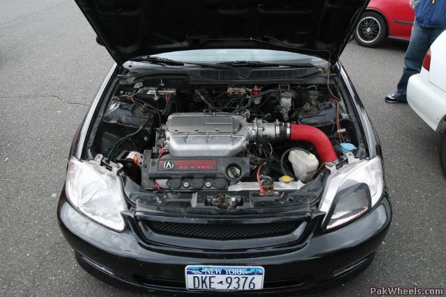

On a side note I have been window shopping swaps that would be frugal. I have decided, after this engine blows, I would like to do a J30A4 (240hp Acoord V6 swap). It looks like it would be cheaper than B or K series swaps and it would have nice torque for the street. Plus a USDM should be more simple to swap in California. I have been searching local salvage yards for swaps, so I can start tuning-up and polishing the block. I can get the transmission later on, when I actually need to swap...

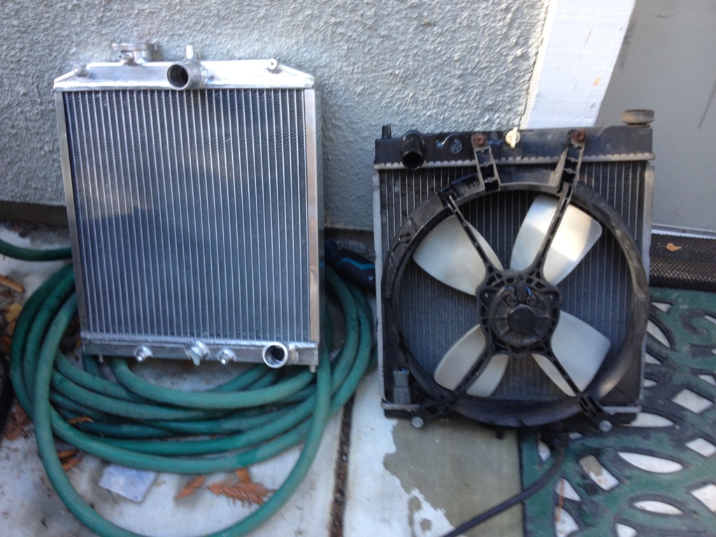

I think I have found to culprit. There is no coolant flowing, the radiator is clogged!
I ordered a brand new brand-X all aluminum radiator to replace it from Amazon. It will arrive next week after Wednesday.

My new radiator arrived today, it is cheap and, so I had to make it fit...
But now that fans kick on and no more overheating!

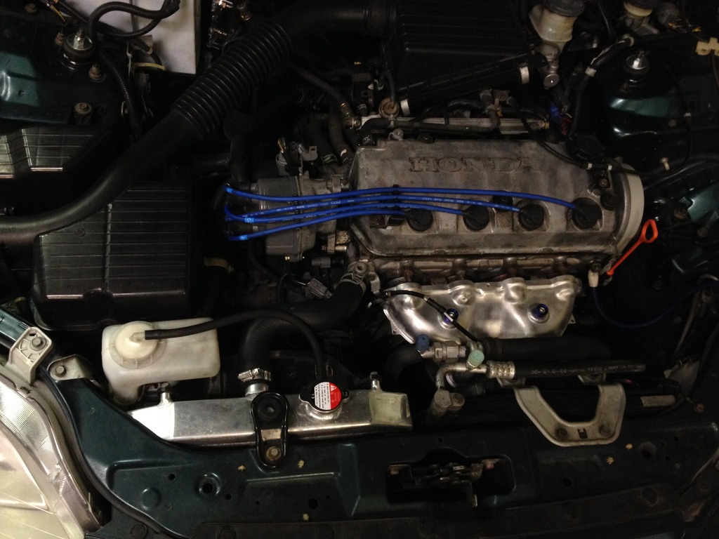

I got the rad in, it looks nice and works well. The stock hoses where a very tight fit.

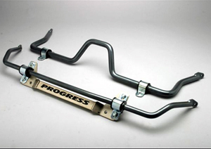

While changing the radiator I saw that the front passenger side strut was leaking. Since I wanted to change the shocks to something a little more sporty. After the new year I will be getting these and lowering at least one inch...
https://progressauto.com/products/sf.../productID/779

$200-300 performance sway bars (performance)

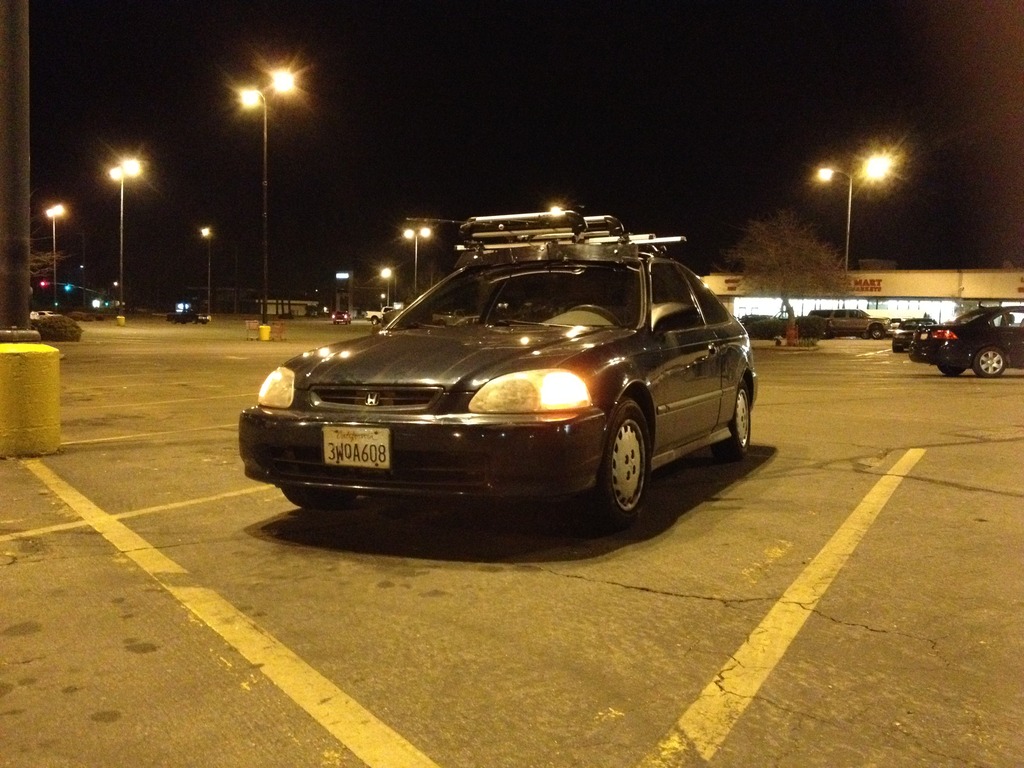

This should cure the exhaust leaks, and the blown shocks. Will be installed next month.

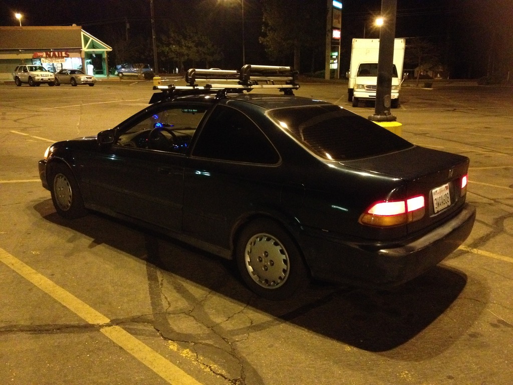

Roof rack ordered!... $70 on Amazon, we will see if it is as cheap as I think it is.
It should all be here by tomorrow.

So everything came yesterday. I went over to the garage this morning and installed all 4 shocks and a new header/cat.
Success!
Exhaust leaks are gone, low end power feels stronger!... so quiet.
The shocks feel great, much smoother than the worn/blown stockies.
I am so glad I fixed the 2 most irritating issues with the car. It no longer sounds like poop or rides like a wooden wagon.
I found that most of the bushings are worn or blown, so I plan to get a poly master bushing kit, start with the rear trailing arm bushing, because they are both torn and are highest priority. I will also be shopping for sway bars around February.

I never got a good header pic without the heat shield, but here she is with the heat shield.
The heat shield got a little cleaning up before installation too.
Toshi also got her roof rack installed, I will post a pic laters.

Roof rack is on! It howled like a wolf until I put the fairing on. I also used my old ski/board/pole rack. I can finally store my fishing poles out of the way and not have to fold down the rear seat as much.
My car is pinging, so I am going to investigate this weekend. I suspect the fuel system has low pressure, maybe a bad pressure regulator or clogged fuel injectors? I will also adjust and check plugs for gap and insure they are the right ones. I checked/adjusted ignition timing with no effect. It may be a air sensor as well. we will see
My suspension master bushing kit and pcv valve grommet are on their way...
