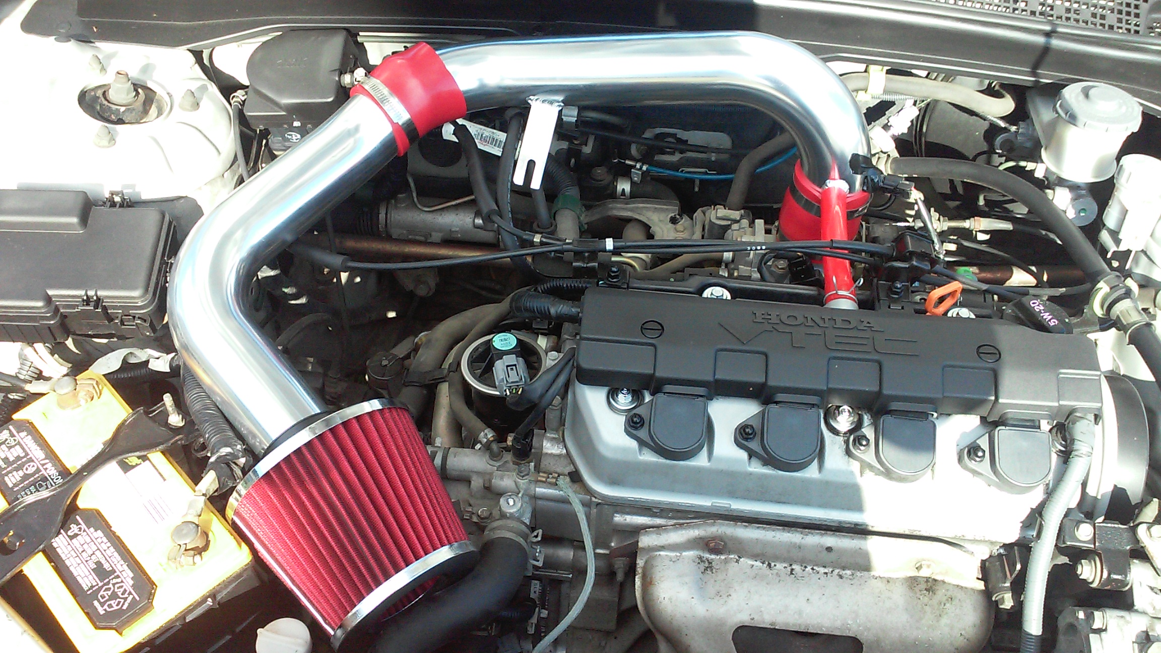

Here is my first part for my civicClick image for larger version

Im gonna do so much to it I cant wait !!!!

if you don't replace that filter with a brand name one like AEM,K&N,Injen, etc etc your going to introduce debris into your engine. don't believe me the next time you remove the filter to clean it check the the walls of the tubing they will be caked with dust. also make sure the filter is not in contact with the hose for your cooling system or vibrations could cause a hole to form. your also missing a hose clamp in the middle connection and whats with all the electrical tape around your air temperature sensor ???

Your center mounting bracket isn't mounted?
New filter would be good. A smaller one would fit better and not hit the hoses.

like these guys said, I don't know much about the sensor, the tape is a bit odd, but missing the clamp is important to fix, and a better quality filter will make a big difference and be much better for your vehicle. The cheaper piping is not a problem, but definitely throw a new filter on there! Nice ride!

Yeah I already fixed the clamp issue and i will pick up a K&N fikter today. Thanks for the tips guys
