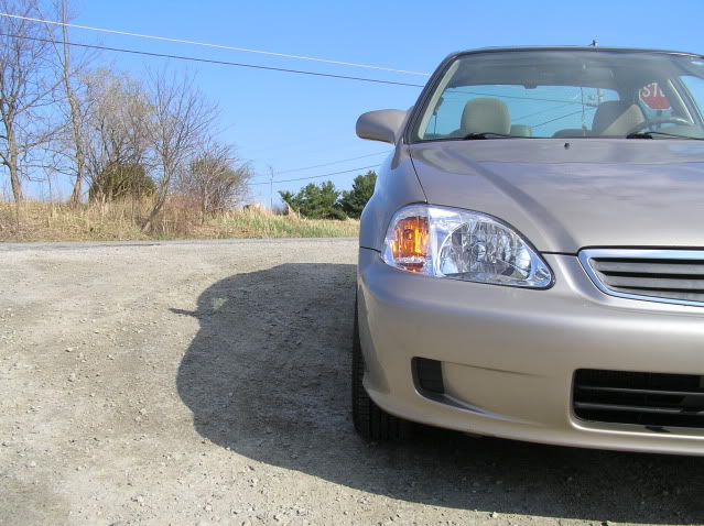

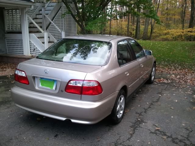

Some pics of pretty much what she looks like now, minus the CTR grill and Type R lip. She's getting a serious scrub-down tomorrow.. will upload fresh pics then ;]

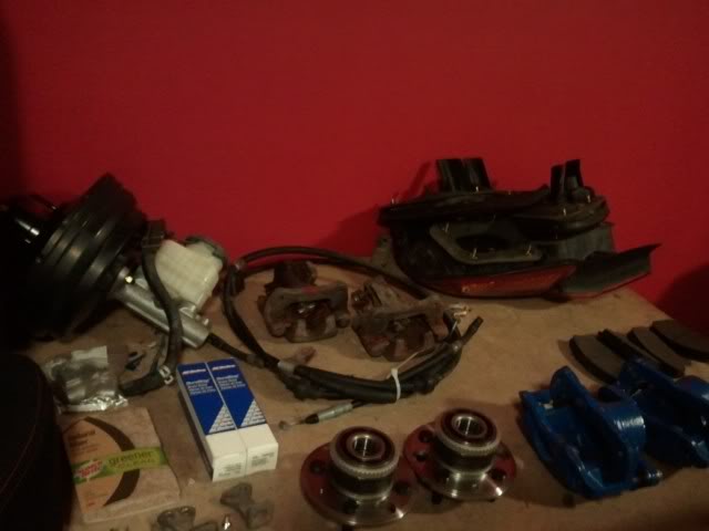

Rear Discs from a 99 Si
1'' MC, new rear wheel bearings, DC2 calipers, 40/40 prop valve, brake lines, e-brake cables, caliper bolts, etc etc.

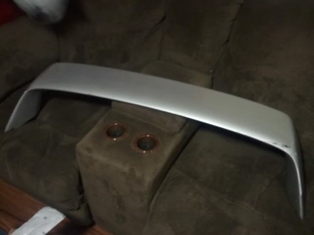

Here's the EK4 tall wing I managed to snag. It's in really rough shape but it's the one wing that I actually really like so I figured it's definitely worth getting re-painted and fitted.

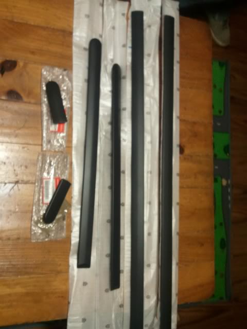

Thin Side Moldings!

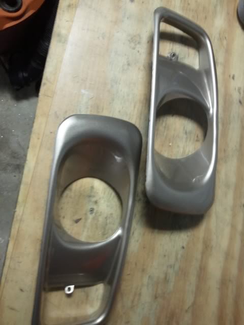

Got my fog light covers back.. was a little disappointed at the quality but realized that most of it will be covered by the lights anyway.

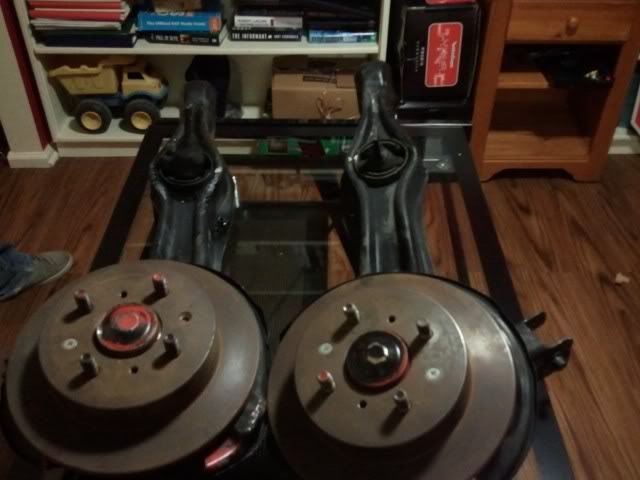

Tonight I'm going to take apart the rear discs and get the trailing arms, hubs and calipers powder coated. Also need to buy a press to put in the new bearings.

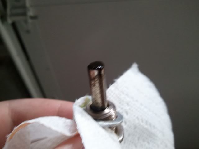

Quick update on disassembling the trailing arms; the huge bolt behind the bearing refuses to come loose.. currently soaking in PB blaster haha.
Also, how stiff can I go on the Koni's without worrying about them blowing?

Disassembled most of the trailing arms to find out I dont have the proper tools to take off the spindle... D'oh! It's dad's b-day tomorrow so project is on hold for now. Looks like I'm taking most of this stuff with me to college haha. Would be a lot more fun than writing papers
